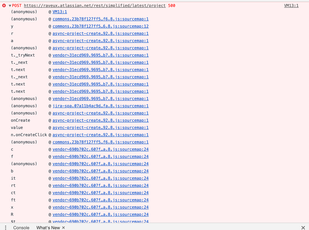

Hi @Angélica Luz thanks for your response, I followed your step but  it doesn't work, I  added the screenshotScreen Shot 2020-04-14 at 10.44.41 AM.png
Angélica Luz
April 16, 2020
Thank you for the screenshot.
Searching for similar issues, I found one that is related to a bug that was already fixed, but some sites are still affected.
Please, go to the Jira settings > Issues > Custom fields.
Search for the Flagged custom field > Click on … > View field information. On this page, I need you to check if the context is set to Global (all issues).
The error I found on the logs about the issue creation is the one below:
"message":"Failed to create project. Project type: ProjectTypeKey{key='software'}. Template: com.pyxis.greenhopper.jira:gh-simplified-agility-scrum. UUID: null","micros_container":"jira","pid":65,"product":"jira","thread":"http-nio-8090-exec-38","time":"2020-04-15T03:25:38.504715601Z","timestamp":"2020-04-15T03:25:38,503Z"}
If the context is not set to global, since the field is locked, I will create a ticket with our support, so it will be possible to access the database in order to change the context of the field.
