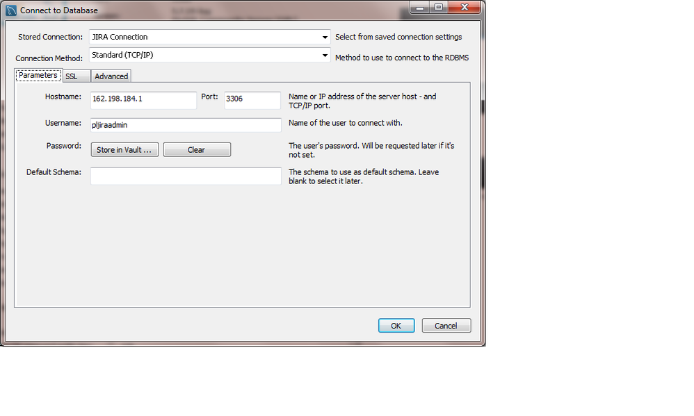

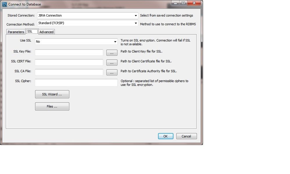

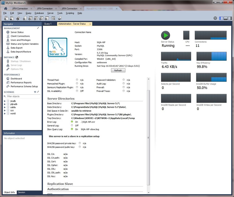

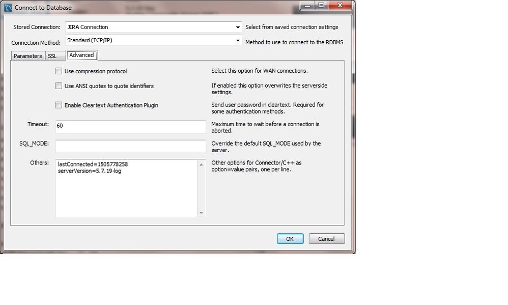

Zachary Thomas
September 19, 2017
Hi Brant,
I switched the ssl to off in the workbench. I don't have access to a connection string to add the useSSL command. I've attached screen shots to show my entries into the Jira Configuration tool and data from the workbench.
Thanks
Zach Thomasjira config tool screenshot.jpgmysql advanced info.jpgmysql connection info.pngmysql ssl info.jpgmysql workbench.jpg
Brant Schroeder
September 20, 2017
What was the outcome of not using SSL?
Zachary Thomas
September 20, 2017
I was still denied access. After a little more trouble shooting, I think the problem is with how I set up the database and how I'm accessing it. I've tried to access the database remotely without using jira configuration tool and just using the command line on another computer and I still get denied access.
