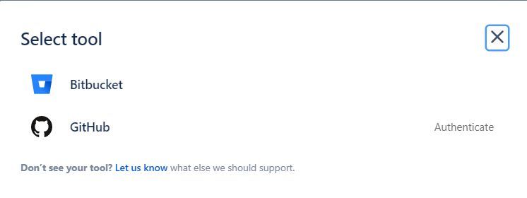

5) But somehow at this stage, The Project cannot connect to a GH Repo. At this screen Project --> ToolChain
6) If I click on the "Github Link", a new tab opens and it shows a blank page. (I refreshed both the GH and Jira website and tried but still same blank page when connecting).

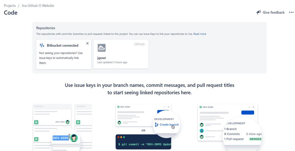

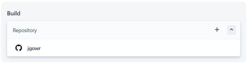

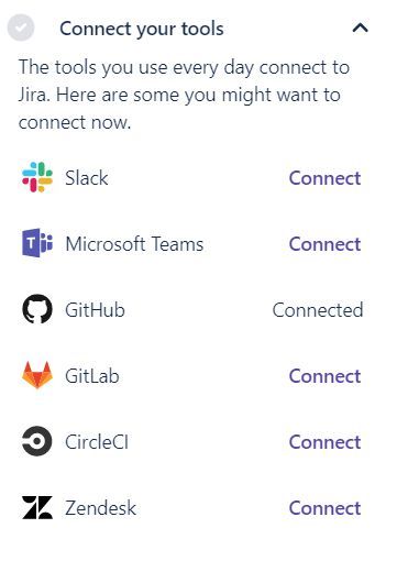

Hi, Thanks for responding. I'm just new to all this. The blank page just went through about a few minutes ago. Now in the ToolChain Page This is what I get:

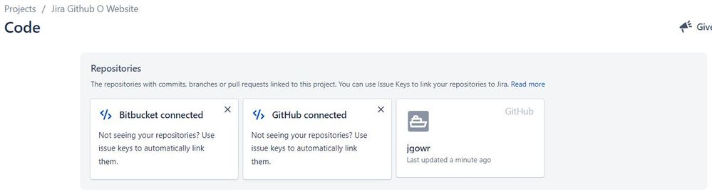

Also Now I'm getting this screen on the Project --> Code Page
So repo is detected (I think?) but is not properly connected to the project perhaps?

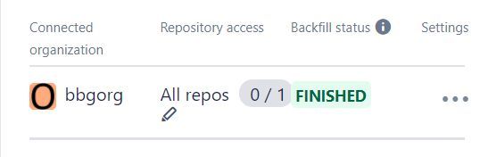

I have started the GH backfill process again in Jira but it is taking too long to complete for just two issues in the repo:

You're on the right track.  You tie the commit to the Jira issue by prefacing the commit comment with the Jira issue ID.

As suggested, I also tried to create another SCRUM, "company-managed" JIRA project and a new private Organization repo and connect both. It still ends up in the situation where the repo is detected but not connected and issues not showing up.

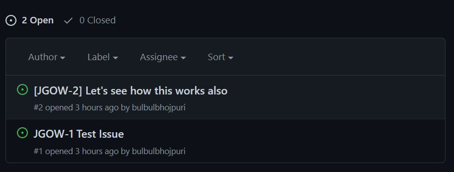

So the GH issues created with Jira project key are independent of Jira Issue right? They won't get copied over into Jira.

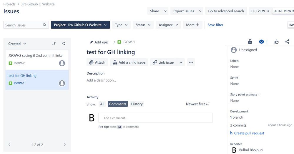

Another query which is related I guess. The Code page is empty even though the Issues page is showing two issues linked to the two commits. Is it normal? or am I doing the wrong flow again? Thanks.
The Issues Page:

The Code page isn't empty.  It's showing the repos that are connected to Jira and where on the Jira issue you can perform actions such as creating a branch, and creating a pull request.

You can sync GitHub issues with Jira issues, but that involves additional integrations from the Atlassian Marketplace.
You cannot create a Jira issue and "hardwire" the Jira issue ID.  Jira determines the ID.

I got it fixed in just 5 mins. Go to App then go to GitHub configuration settings and Restart Backfill, once the backfill is complete you go and search for your repo and add it quickly.
