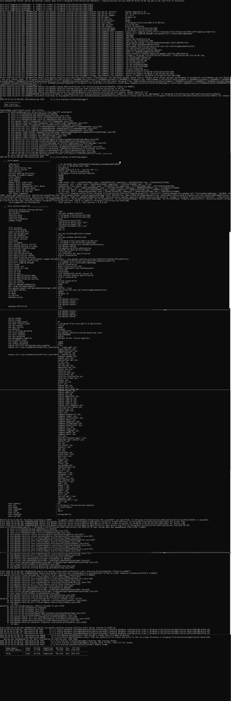

Massimo Scola
October 28, 2018
This is the log after I ran start-jira - in the Tomcat command prompt
Many error messages ... I have pasted everything on pastebin + screenshot + and some error messages:
https://pastebin.com/raw/LBG4bSwm
Errors: (some)
Java HotSpot(TM) 64-Bit Server VM warning: Cannot open file C:\Program Files\Atlassian\JIRA\bin\..\logs\atlassian-jira-gc-2018-10-29_01-14-04.log due to No such file or directory
java.util.logging.ErrorManager: 4: Unable to create [C:\Program Files\Atlassian\JIRA\logs]
29-Oct-2018 01:14:06.972 INFORMATION [main] org.apache.catalina.core.AprLifecycleListener.lifecycleEvent The APR based Apache Tomcat Native library which allows optimal performance in production environments was not found on the java.library.path: [C:\Program Files\Java\jdk1.8.0_181\jre\bin;C:\WINDOWS\Sun\Java\bin;C:\WINDOWS\system32;C:\WINDOWS;C:\Program Files (x86)\Common Files\Oracle\Java\javapath;C:\WINDOWS\system32;C:\WINDOWS;C:\WINDOWS\System32\Wbem;C:\WINDOWS\System32\WindowsPowerShell\v1.0\;C:\WINDOWS\System32\OpenSSH\;C:\Program Files\Git\cmd;C:\Program Files (x86)\NVIDIA Corporation\PhysX\Common;C:\WINDOWS\system32;C:\WINDOWS;C:\WINDOWS\System32\Wbem;C:\WINDOWS\System32\WindowsPowerShell\v1.0\;C:\WINDOWS\System32\OpenSSH\;C:\Program Files\Java\jdk1.8.0_181\bin;C:\Users\massi\AppData\Local\Microsoft\WindowsApps;C:\Users\massi\AppData\Local\GitHubDesktop\bin;%USERPROFILE%\AppData\Local\Microsoft\WindowsApps;;.]
29-Oct-2018 01:14:07.090 INFORMATION [main] org.apache.coyote.AbstractProtocol.init Initializing ProtocolHandler ["http-nio-8080"]
29-Oct-2018 01:14:07.100 INFORMATION [main] org.apache.catalina.startup.Catalina.load Initialization processed in 507 ms
29-Oct-2018 01:14:07.109 INFORMATION [main] org.apache.catalina.core.StandardService.startInternal Starting service [Catalina]
29-Oct-2018 01:14:07.109 INFORMATION [main] org.apache.catalina.core.StandardEngine.startInternal Starting Servlet Engine: Apache Tomcat/8.5.32
29-Oct-2018 01:14:07.121 SCHWERWIEGEND [Catalina-startStop-1] org.apache.catalina.startup.HostConfig.beforeStart Unable to create directory for deployment: [C:\Program Files\Atlassian\JIRA\conf\Catalina\localhost]
29-Oct-2018 01:14:07.134 WARNUNG [localhost-startStop-1] org.apache.catalina.core.StandardContext.postWorkDirectory Failed to create work directory [C:\Program Files\Atlassian\JIRA\work\Catalina\localhost\ROOT] for context []
JIRA starting...
log4j:ERROR setFile(null,true) call failed.
java.io.FileNotFoundException: atlassian-jira.log (Zugriff verweigert)
at java.io.FileOutputStream.open0(Native Method)
at java.io.FileOutputStream.open(FileOutputStream.java:270)
at java.io.FileOutputStream.<init>(FileOutputStream.java:213)
at java.io.FileOutputStream.<init>(FileOutputStream.java:133)
at org.apache.log4j.FileAppender.setFile(FileAppender.java:294)
at org.apache.log4j.RollingFileAppender.setFile(RollingFileAppender.java:207)
at org.apache.log4j.FileAppender.activateOptions(FileAppender.java:165)
at com.atlassian.jira.logging.JiraHomeAppender.configureAppender(JiraHomeAppender.java:267)
at com.atlassian.jira.logging.JiraHomeAppender.doAppendSync(JiraHomeAppender.java:222)
at com.atlassian.jira.logging.JiraHomeAppender.doAppend(JiraHomeAppender.java:208)
at org.apache.log4j.helpers.AppenderAttachableImpl.appendLoopOnAppenders(AppenderAttachableImpl.java:66)
at org.apache.log4j.Category.callAppenders(Category.java:206)
at org.apache.log4j.Category.forcedLog(Category.java:391)
at org.apache.log4j.Category.log(Category.java:838)
at com.atlassian.jira.startup.FormattedLogMsg.printMessageImpl(FormattedLogMsg.java:192)
at com.atlassian.jira.startup.FormattedLogMsg.printMessage(FormattedLogMsg.java:173)
at com.atlassian.jira.startup.JiraStartupLogger.printStartingMessage(JiraStartupLogger.java:82)
at com.atlassian.jira.startup.SystemInfoLauncher.start(SystemInfoLauncher.java:23)
at com.atlassian.jira.startup.DefaultJiraLauncher.preDbLaunch(DefaultJiraLauncher.java:114)
at com.atlassian.jira.startup.DefaultJiraLauncher.lambda$start$0(DefaultJiraLauncher.java:101)
at com.atlassian.jira.util.devspeed.JiraDevSpeedTimer.run(JiraDevSpeedTimer.java:31)
at com.atlassian.jira.startup.DefaultJiraLauncher.start(DefaultJiraLauncher.java:100)
at com.atlassian.jira.startup.LauncherContextListener.initSlowStuff(LauncherContextListener.java:154)
at java.lang.Thread.run(Thread.java:748)
