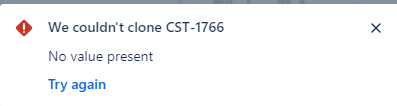

A user who has always been able to clone issues has recently been receiving the above error. Permissions haven't changed at all. They can still create and edit issues from scratch, so I don't know how else to address this.

@Brian Sweet Any news from Atlassian so far? When I open https://support.atlassian.com/requests/JST-1089467/ there is only the message "Unable to display request". Does that mean, I don't have access?
I am running into the same problem, but on my site these is only one user affected in one specific project. Same thing, no changes at all in the last 3 month to users/fields/workflows, etc. The user has create issues permission and all of the sudden this single user is not able to clone issues anymore (create issues is working).
Furthermore, it would be helpful if the error message would inform you of WHICH field the value is missing...
EDIT:
I've tested a bit and can add that users with said issue when cloning only get the field summary and checkboxes for links and comments in the clone popup, while other users with the same permissions but no cloning error still have the assignee field.
EDIT2:
I found out that the only difference between the two users was that one of them had the Assign Issue permission. Giving this permission to the other user solved the problem! So you need to make sure that any user who shall be able to clone issues in a given project has the Assign Issue permission (no idea why this dependency exists).

Here's what I found when a clone is initiated:
"self": "https://versanthealth.atlassian.net/rest/api/3/task/208929",
"id": "208929",
"description": "Clone [redacted]",
"status": "FAILED",
"message": "Preparing cloning machine",
"result": "No value present",
"submittedBy": [redacted],
"progress": 0,
"elapsedRuntime": 0,
"submitted": 1736866275002,
"started": 1736866275118,
"finished": 1736866275370,
"lastUpdate": 1736866275370
