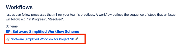

Once you go back to your project, click on Summary then click on the workflow (not workflow scheme). Something similar to my screenshot below:

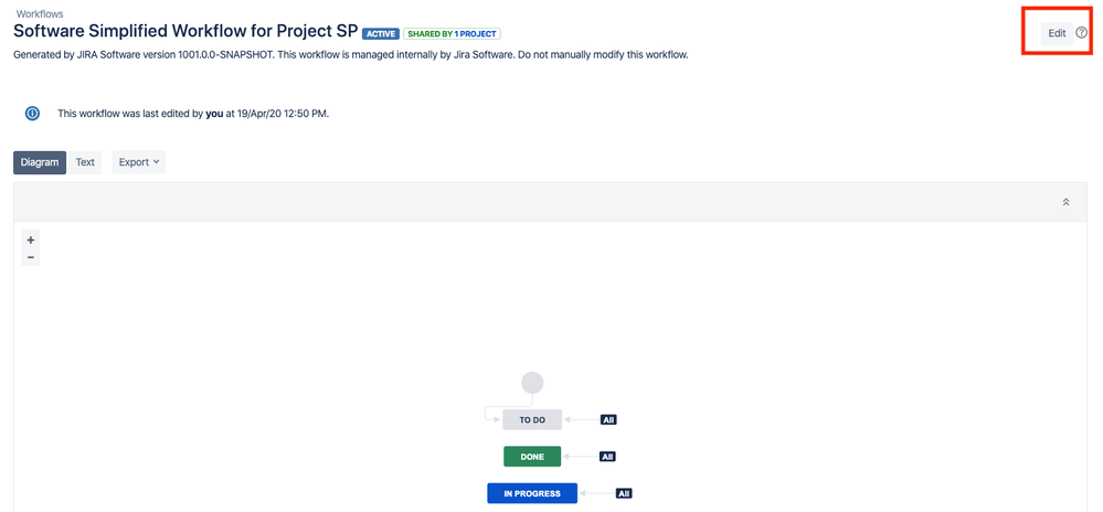

Then you will see a screen like the following, make sure to select diagram. You can add statuses using text mode as well. Right now I am trying to make it easy for you

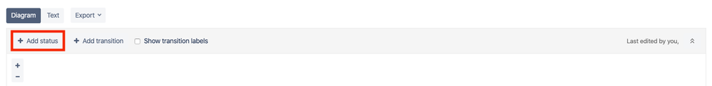

Screen Shot 2020-04-20 at 11.21.38 AM.pngClick Diagram, then click on "Edit"
Once you edit your workflow, click on "Add status". You should be able to see on the dropdown all the statuses available in your instance.

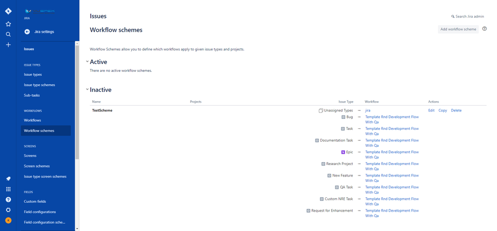

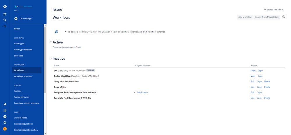

Here is my Workflow and Workflow Schemes I cannot ever get them to appear differentl. thank you!!!
