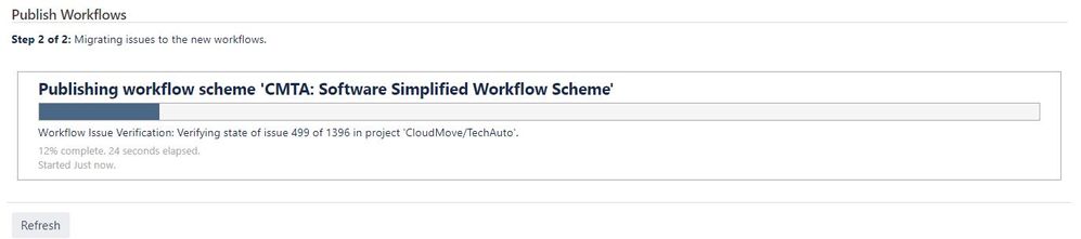

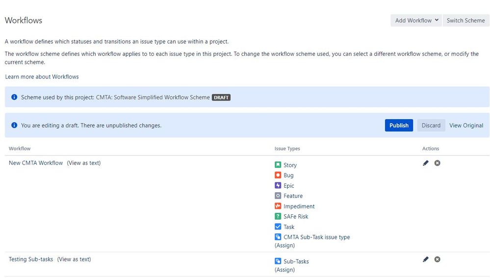

It starts the process:

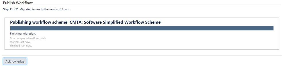

I get the Acknowledgment that it has completed the changes, and then it goes back to the previous screen and asks me if I'd like to publish my changes to the workflow. please see image:
I've checked a few times if it has actually made the changes it says it has, just in case the message is wrong, but then the message isn't wrong at all.
The whole change it goes through does nothing and I am asked if I'd like to
Ah, it's because you are using a simplified Workflow Scheme. You will need to create a new Workflow scheme that uses those two workflows. :-(
Create the workflow first, and then add the two workflows in. And then change the workflow scheme on the project from the current one to the new one you created.

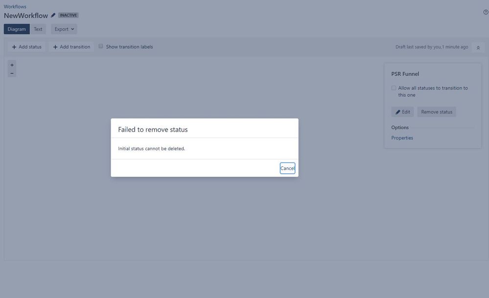

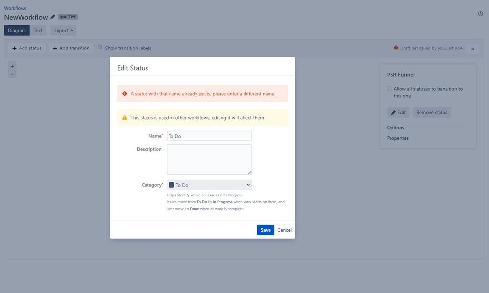

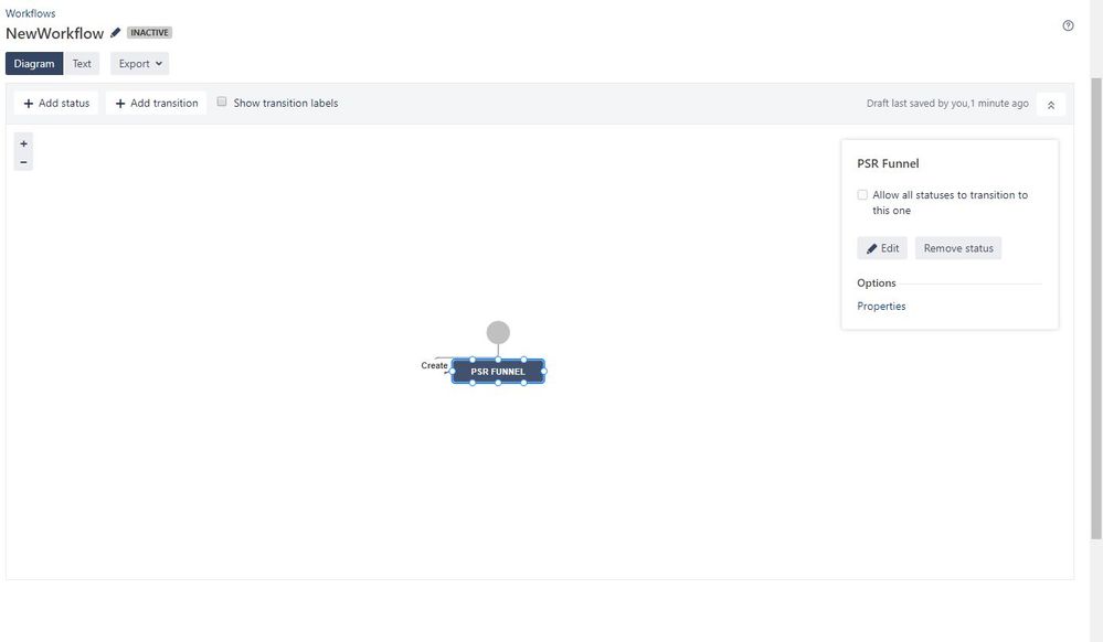

Hi John, the first pic is the new Default status
2nd pic is me trying to delete it
3rd pic is me trying to change it
I would start with the existing Simplified one and just copy that. Then make changes to the copied one.

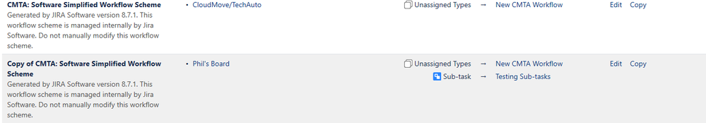

I have copied the workflow, I did this before I originally posted the query.
Here's a pic of the original and the copied, the copied works but doesn't have the 1700 issues within it

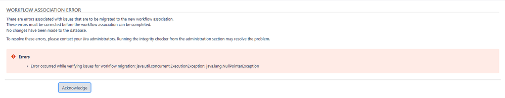

Hi John, i really appreciate your time with this.
So i have attached the new workflow scheme to the CloudMove/TechAuto project, and i get an error.
Please see picture
You might try doing a re-index first. If you still get the error after that, I would go ahead and submit a support ticket with Atlassian. :-(
