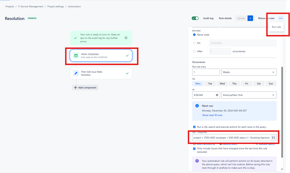

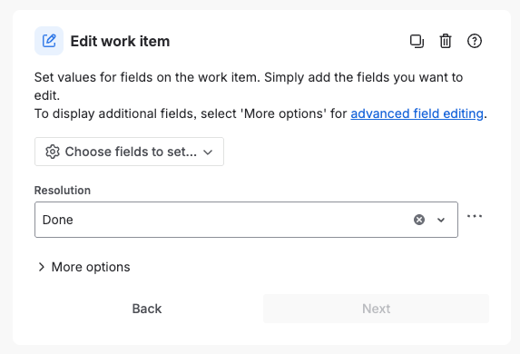

@Mike Albanese If they are unique tickets and if you can get a JQL statement for it, you should be able to use automation to change it.
Ismail Sanni
December 23, 2024
@Mike Albanese
1. Get a JQL statement for the issues
2. Go to Automation
* Trigger - "Schedule"
* Add the JQL statement
* Add an action to add a resolution. Make sure to uncheck the send email option.
3. Run the rule.
You can delete the automation when you are done.
