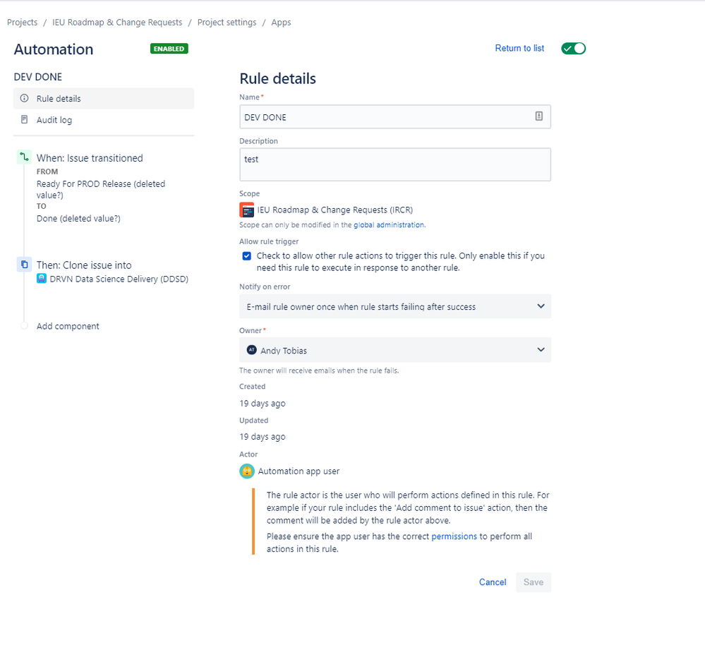

Hi John - this is what i have done so far.. which has not worked. both projects are Next Generation projects.
John Funk
July 15, 2020
So what is not working? Is it not firing at all?
The problem might be that Next-gen Projects have separate statuses that build up. So when you select the Done status, you need to make sure it is the Done status for the Next-gen project you are working with. (You are probably seeing multiple Done statuses in the list to choose from).

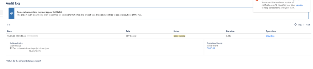

Have you looked at the audit log for the rule to see what it indicates is happening?  That will tell you if the rule is even getting triggered, or if there are other issues.
Regarding my earlier comment, it appears that when you clone, the status is set to the first status of the workflow and the resolution is cleared.  So there should not be any need to change the status as part of cloning.
Andy Tobias
July 17, 2020
Hi Bill,
Below is the Audit Log that i get when i transition a task from one part of the worklfow to another and the response says "can not create issue in project/issue type"
Now their cant be anything wrong with the issue type as i use the same issue types in all the projects with the same fields, so i can only see the issue as a problem with the cloning of a ticket into a new Project.
John Funk
July 17, 2020
I would start by looking at the permission scheme for the target project. Be sure that the Browse Projects and Create Issue permissions are available to the atlassian-addons-project-access Project Role.
