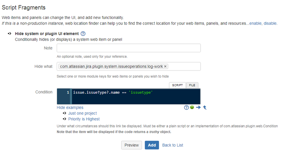

You could use Web Fragments in ScriptRunner and create the Hide system or plugin UI element. If would look like this:
hideui.pngOr you could use wokflow properties. You can find more info here:

is the first option hides the "Log Work" in the issue view page?
I tried doing this, though not working.

1. Log work button.
Maybe it is not a core Jira log work button, but a Tempo work log button?

Lacey Also
October 7, 2020
If you want to completely disable it, you need to edit the statement to be "truthy" against Task. Meaning, if the issue type is NOT Task, then show the button.
!= "Task" rather than == "Task"
