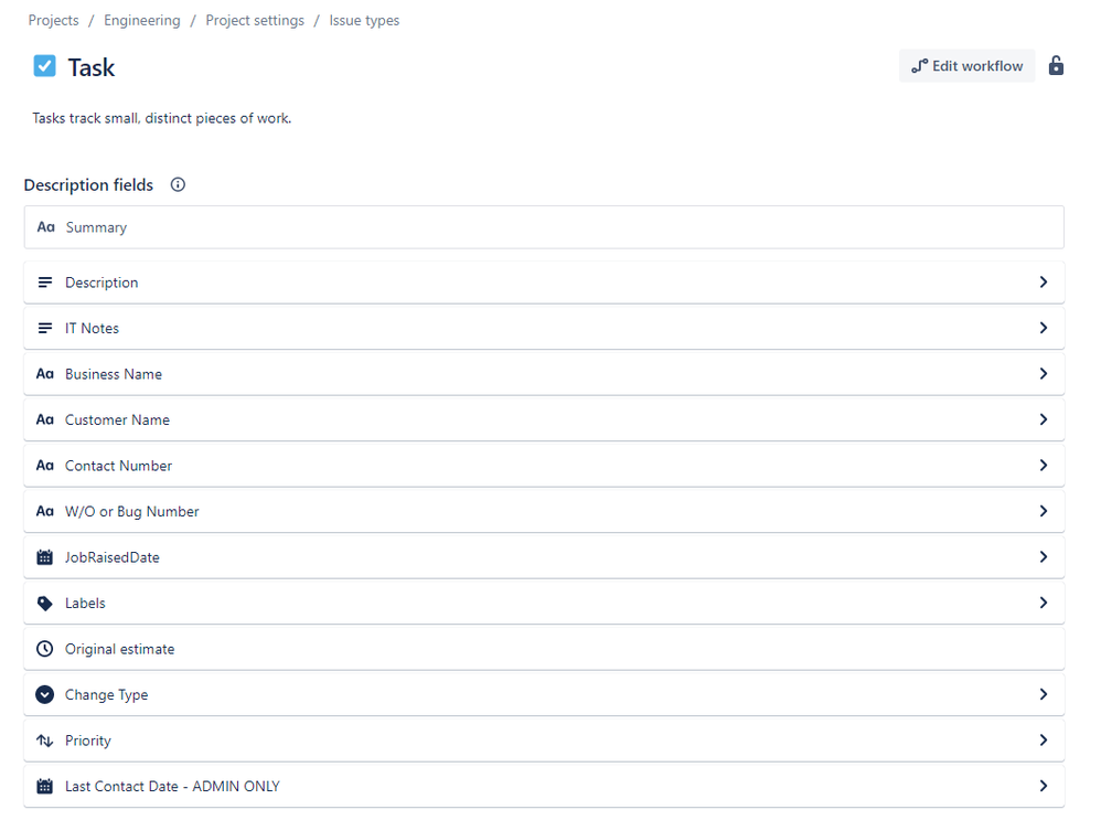

Yeah Im still having the same issue with it. It keeps returning the same issue saying "It is not on the appropriate screen, or unknown.". Here is a screenshot of my field configuraion and original estimate is definitely there:FieldExamples.png

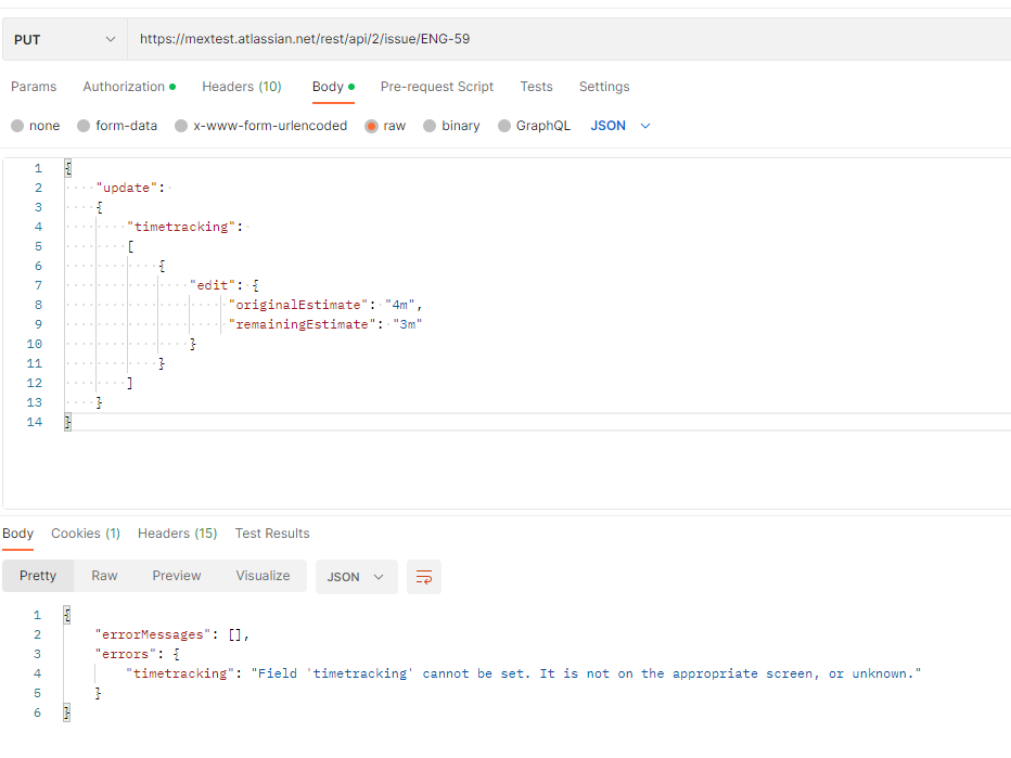

var content = new StringContent("{\"update\":{\"timetracking\":[{\"edit\":{\"originalEstimate\": \"4m\",\"remainingEstimate\": \"3m\"} }]}}", Encoding.UTF8, "application/json");
using (var response = await client.PutAsync($"{JiraClient.baseUrl}/rest/api/2/issue/{ticketID}", content))
if (!response.IsSuccessStatusCode)
var responseJson = await response.Content.ReadAsStringAsync();
Console.WriteLine($"Failed to update issue: {response.ReasonPhrase}");
Any ideas why this should still be saying the field doesn't exist?

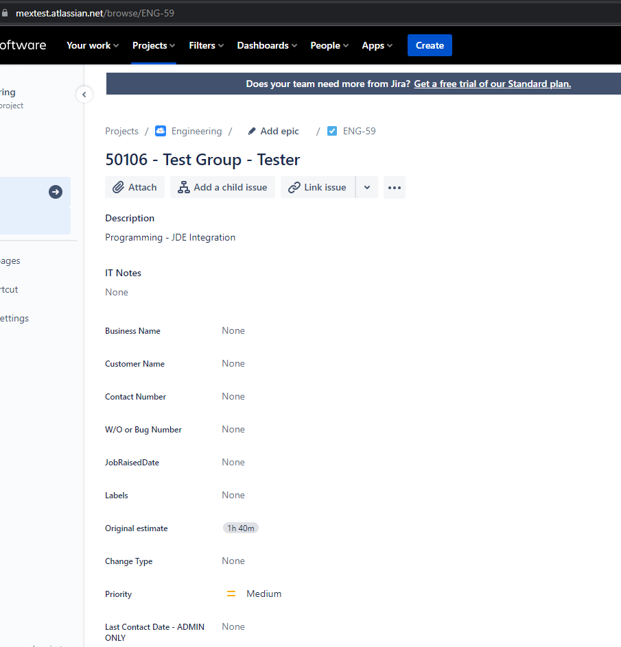

I've double checked and the field exists in the edit screen. Here is a screenshot of the ticket Im trying to update in this example:

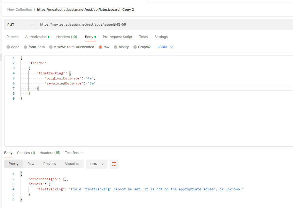

I've put the calls into postman and still getting the same returns. Here are screenshots of the put methods I tried to update the ticket.
Any issues that you can see with the calls or edit?

I've found what the issue was. I had the originalEstimate field in the details. I needed to also add the Time Tracking field to the context fields.

I have also tested at my end and this part of code worked for me:
    "fields": {
         "timetracking": {
            "originalEstimate""3m",
            "remainingEstimate""4m"
