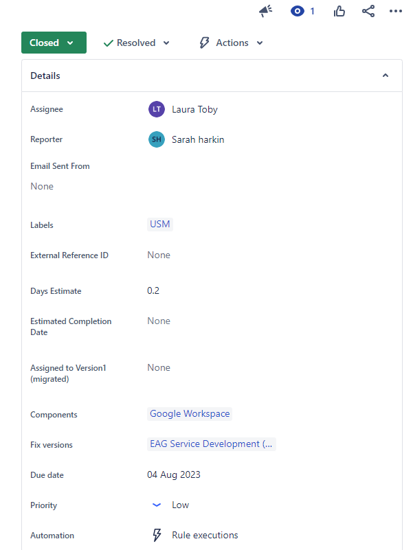

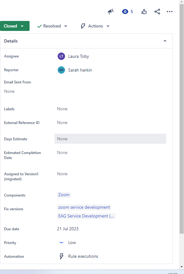

Laura Toby
August 2, 2023
This issue is closed but appears on my board, It has 2 fix versions but I only have one in my filter.
This issue is also closed and does not appear in my backlog.
Both issues are the same issue type in my project.
