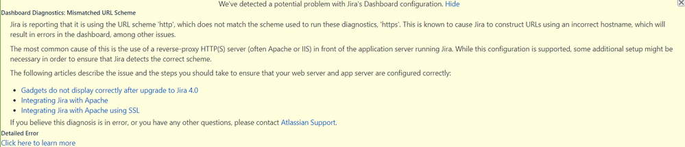

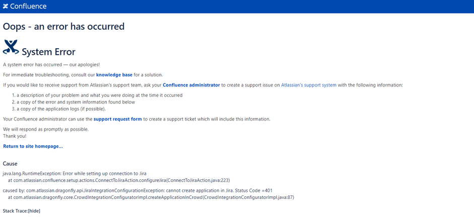

Ultimately the Problem I'm trying to resolve is this
Screenshot 2020-11-04 120052.pngThis occurs when I try to connect confluence to jira to manage my users. When checking the application integration status from Jira's end I see this.

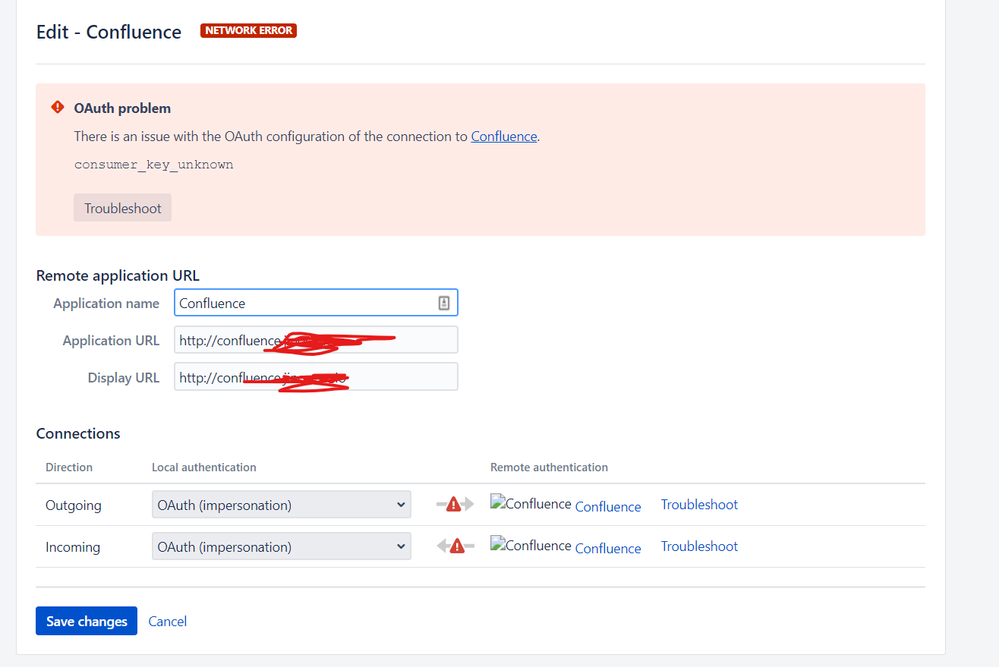

My goal is to integrate confluence and jira, while having jira handle the user management. That should allow me to have the same account on both. However, during the connection process Confluence throws a system error. Inspecting the problem on Jira's side yields a network error specifying:
oauth_problem=consumer_key_unknown
My assumption is that this is caused due to an incorrect reverse proxy configuration.
 Screenshot 2020-11-03 172500.pngThis is why I'm trying to configure the Proxy environment variables, but I think I'm missing something.

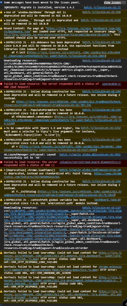

Here is my console log information

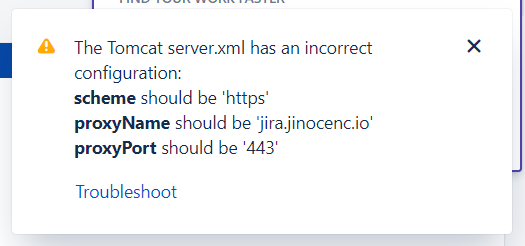

The picture you upload above shows that ATL parameters didn't match config correctly. Let's try one more scenario.
