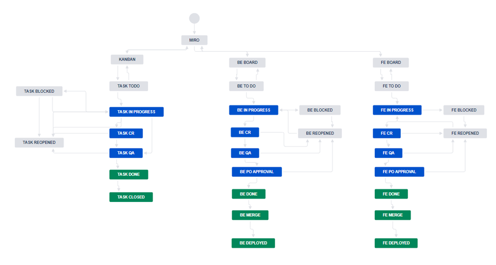

adding to what Carlos said please also check for the transition permission (screenshots did not came through fully, I think).
Also the error message is suggesting the destination status should be 'CR' but I could not recognize such workflow step from your first screenshot.

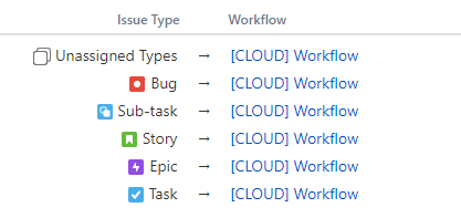

Sub-Tasks are in the same workflow as the other tasks (can be moved by team members) - see attached 2021-07-02 08_55_42-Window.png.
I also attached the said workflow  - see 2021-07-02 08_57_07-Window.png.

2021-07-02 08_55_42-Window.png2021-07-02 08_57_07-Window.png2021-07-02 08_58_44-Window.png2021-07-02 09_05_14-Window.png

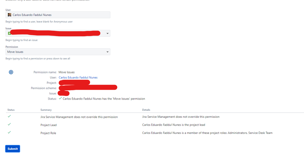

@Ajda Grudenin this case, both projects CLOUD and CR have the same permission scheme and the same team ?
This appear to bem permission.
If you want to try, use the "Permission Helper" (G+G type Permission Helper) and type user, key (Cloud-83 or um can use CR-XXX) and user the permission Move Issues.
Este erro parece estar relacionado a problemas de permissão de movimentação
