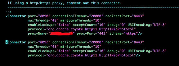

Define a separate HTTP connector with a different port in each app server.xml file. Here an extra connector for confluence:

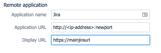

Then use them as Application URL on Both sides and Use Https address for Display URL.

The example you show looks like it is the server.xml for confluence. Is that correct? I tried to follow the steps, but I got a server error when I tried to connect. Do I need to specify an ip address in the connector? Does jira's server.xml need an additional connector for http? It already has an additional Standard HTTP connector using port 8081 (in addition to 8080).
I've made sure that the firewalls for those ports were open, but still just get network errors.
