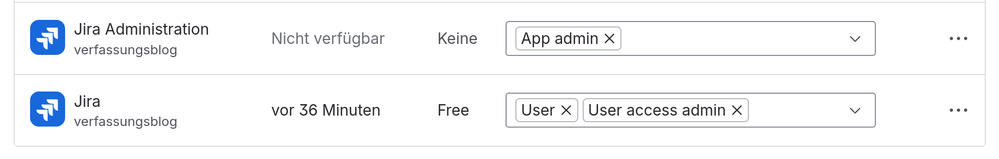

Make sure you have assigned yourself roles as follows:
Then try again to delete issues.

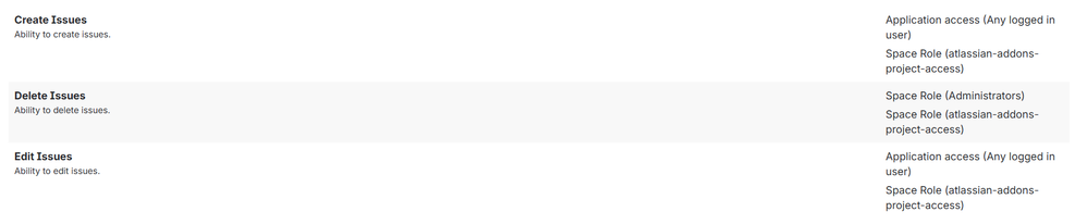

I'm in the roles in the Organization settings: 2025-12-01_18-51.png

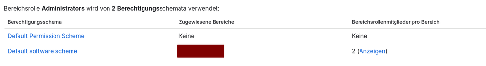

But in the space, I'm not listed under members and can't add myself (due to free plan). There are two additional members and those are listed for the Administrator role but not myself:2025-12-01_18-55.png
I also added the "jira-admins-verfassungsblog" group to me, but that didn't change anything. I also can't modify the permission schemes.

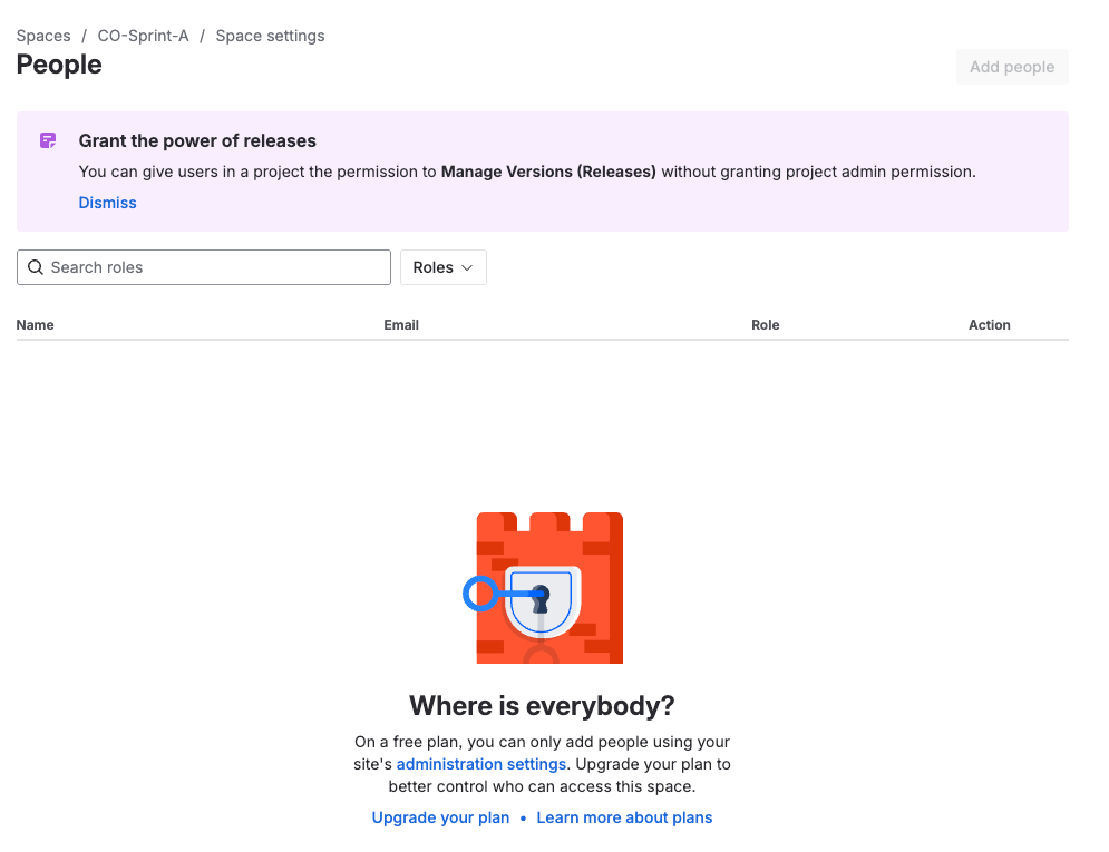

If that is correct, when you go to Space Settings and then select People, do you see any people listed? Or is it blank like this?

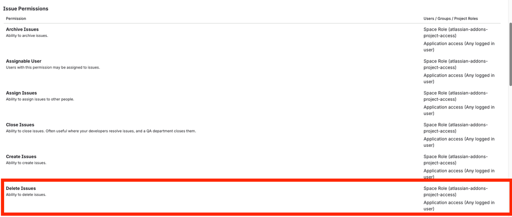

When you go to Space Settings and then select Permissions, and find the entry for Delete Issue, what does it show on the right side?

I am on the free trial and when I go to the Space Settings and then select People it is blank.
The on screen coach marks direct me to go to Jira Admin Settings to add people, but Jira Admin Settings take me back to the Space Settings, which direct me to go to Jira Admin Settings... ad infinitum.

  6. when you go to Space Settings and then select People, do you see any people listed? Or is it blank like this?
    • It is blank like the photos you shared

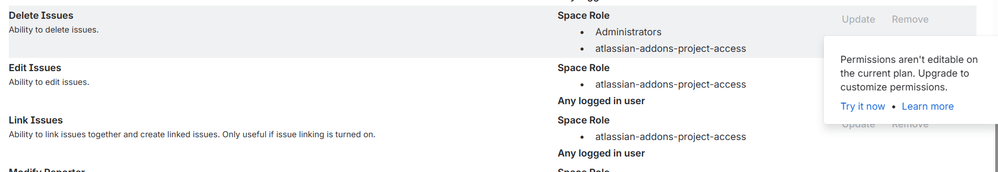

Just default settings like so:
Trudy Claspill
December 22, 2025
Thank you for that screen image.
Those are not the default settings. That permission scheme has been modified. Take a closer look at the image I provided.
The permission needs to be allocated to "Application access (Any logged in user)"
As it is currently set only users in the Administrator role and apps and Automation rules can delete items  in the free plan you cannot add users to space roles, so you will need to change the permission scheme

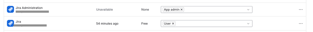

How/where would I go about doing that?
When I look at the permissions in the space settings it says I cannot change them on the current plan, hence the assumption about them being default.
Trudy Claspill
December 22, 2025
You have a couple of choices.
Choice #1 is to temporarily upgrade your subscription to the Standard plan. You can then edit the Permission scheme. Then downgrade your subscription back to the Free plan.
Choice #2 is to review the available permission schemes to find one where the permissions are all granted as they normally are by default, and through the Space's settings change the project to use that Permission Scheme instead. Usually the Company Managed Software project get a copy of the Permission Scheme named "Default Software Scheme".
