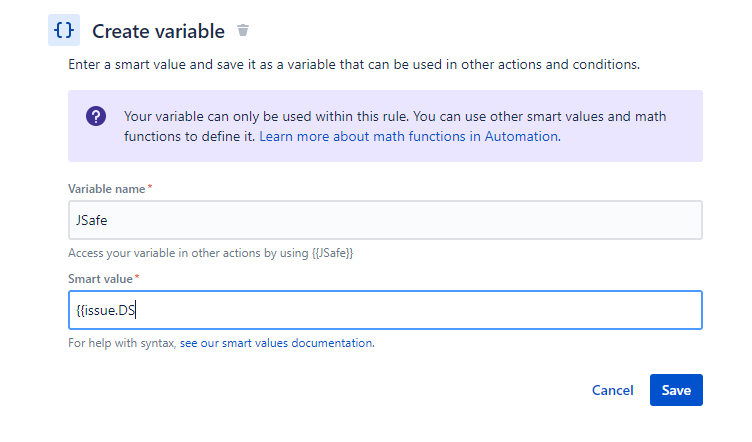

I'm trying to define a smart value variable. I want to concatenate some text with the value of an issue field.
In the smart value action to define a vaiable I enter the variable name and in the "Smart Value" field I'm trying to enter the smart value reference to my custom field ("DS Safe") but I can't enter a space character in the field. Since I can't type a space character in the box, I can't reference my field. Yes, I know I can use customfield_xxxx to reference the field but I'd rather use the name.
The even stranger thing is I can "paste" a space in that box. So if I create the value outside this dialog "{{issue.DS Safe}}" I can paste it and it works.
This seems like a bug. Anyone else seeing this?

Atlassian confirmed this is a bug
https://jira.atlassian.com/browse/AUTO-344
Workaround is to copy/paste or enter the text without spaces and then go back and add the spaces. Turns out you can enter spaces between characters just not at the start or end of a line.

try
{{issue."DS Safe"}}
Tom Hudgins
February 13, 2023
Nope. I physically can't type a space character in either box in that dialog - whether it's quoted or not.
