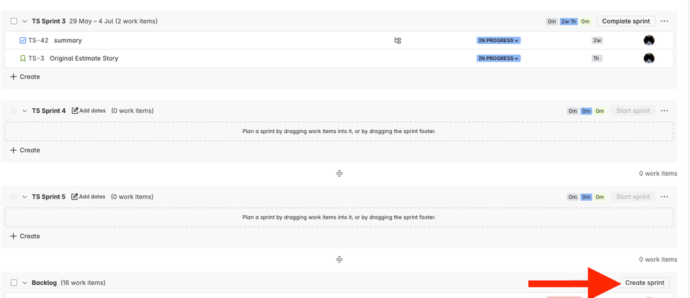

Regarding your second question about creating more than one sprint at a time, you should be able to create multiple sprints, and populate them with issues. You would find the button for creating sprints at the top of the Backlog list within the Backlog screen.
Are you not finding that button available, or finding it disabled, when you already have one unstarted sprint in your Backlog screen?
