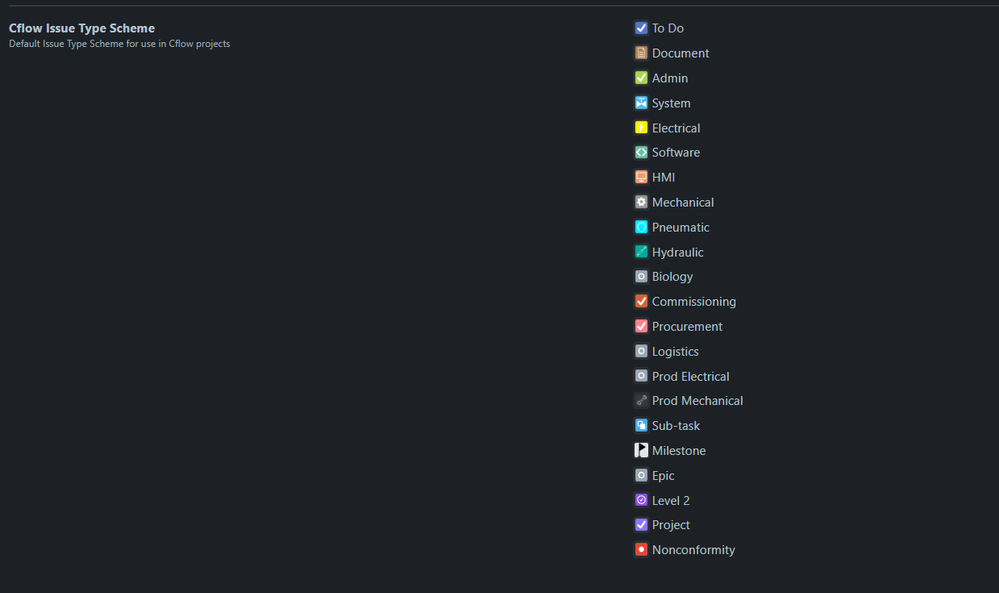

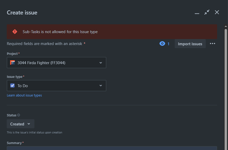

I'm getting this error message when creating a cetain issue type called "Todo".
I've analyzed the issue type to find any difference to other issue types that are working as they should, but at this point im clueless of whats wrong.

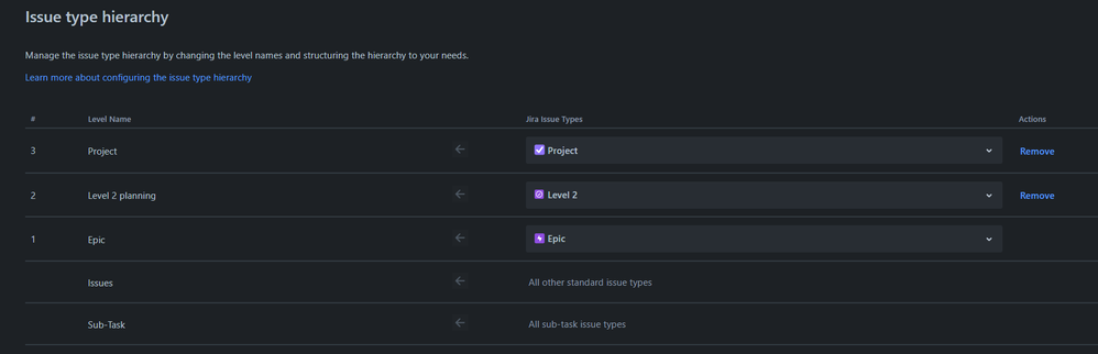

Sub-tasks are defined in an own issue type, the sub-task issue type are on -1 in the issue hierarchy. "Sub-task" issue type are configured as an subtask type of issue in the config.
Todo issue are on level 0.

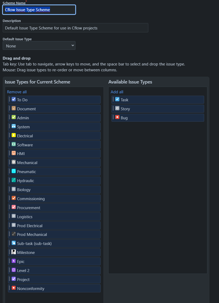

Both issue types are configured in the issue type scheme used in the project.

Actually I hadn't checked the workflow scheme. There was an error there, the To Do issue type was assigned to the subtask workflow. Reassigned it and problem solved.

Anyway, the question.  You have a validator or Behaviour on this issue type that is telling you that you're not allowed to create sub-tasks on the issue type.
Jira does not have any functionality that blocks sub-task creation on specific issue types.  If there is one or more sub-task types in the issue type scheme, then that type can be created below any base-level issue type.
So someone has coded something to give you this message.  If it's a Behaviour, it's only a warning, you can ignore it.  If it is a validator, then you're going to need to either get it fixed (i.e. removed, because it's a bad pattern, blocking your work), or change what your are entering into the issue such that you do not trigger it.
