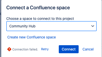

I've tried to connect my JIRA project with a confluence project, but it's not working and I don't know why.
All I see is "Connection failed" and I'm not sure why.
My JIRA dn Confluence instance work. I'm able to access both with the same client session/browser session.
Did anybody else experience this? Any ideas how to resolve this?

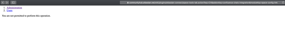

Community_Hub
January 14, 2020
Thanks, that didn't work as expected;)
I've run into an error here ( No Perm Error) , which I guess was also the reason for the issue.
Once the error was resolved by clicking on "Administration"
it worked as expected.
BTW regarding your step 3, the JIRA link was already there.
Thanks for the heads up.

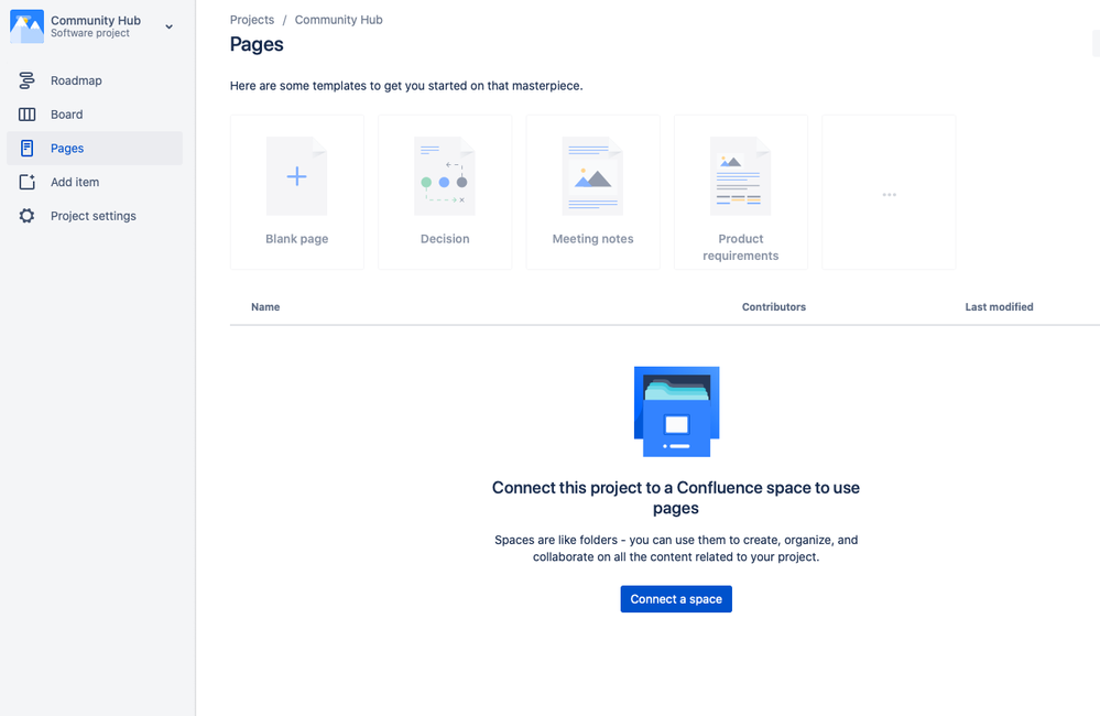

My Project is a next gen project.
Inside the jira project I've clicked on "Pages" and "Connect a Space". This will open the above form, where I've tried to select the existing project and which then  results in the error.
The connection works def. because I'm able to create a new confluence project from the form, only connecting to an existing project fails unfortunately
