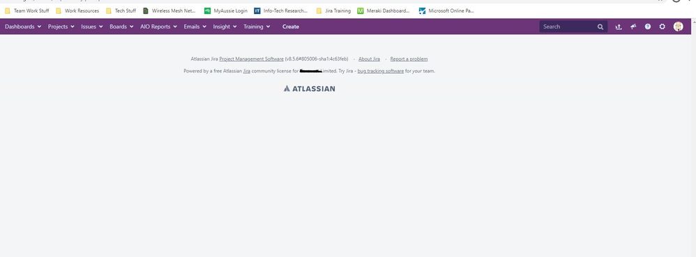

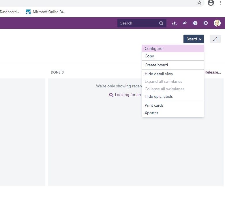

I have set up a new project as a Jira Admin for our PMO and we are trying to configure a new Kanban board (add a few extra columns). When we click on Board/Configure, Jira thinks for a bit and then takes you to a page with the top banner and the Atlassian footer but no options to change anything. Also none of the links from the header will respond when you click on them. We don't get an error message. (see attached screen shot)

We are running Jira Server (on-Prem) version 8.5.6Jira configure board error 1.jpgJira configure board error.jpg
