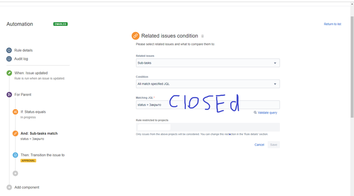

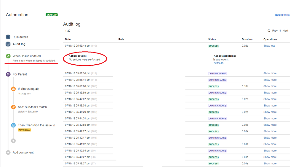

Placed 2 photos to explane my problem. Can community assist me and explane why parent issue can't become closed? I've updated my parent issue few times.

Scheme:
If parent issue's status is in progress and subtasks are closed parent issue must be transited into approval status when updated.

is QMS-16 the parent or the subtask?
The way your rule is currently written.
  • When an issue is updated
    • Look for the parent of the updated issue.
    • Check
      • Check that that issue (the parent) is in progress
      • check that all subtasks of the parent are close
    • If both are true, transition that issue.
The key is that the process starts with an update to the subtask. not the parent. If you update the parent, it has no parents so nothing happens. You need to update the subtask to transition the parent.
If you want the automation to take place on an update of the parent, then you would want a different rule
    • If that issue has subtasks
    • And all those subtasks are closed
  • Then transition that issue.
Notice the point of view change. The automation in that case starts with an update to the parent, not the subtask.
