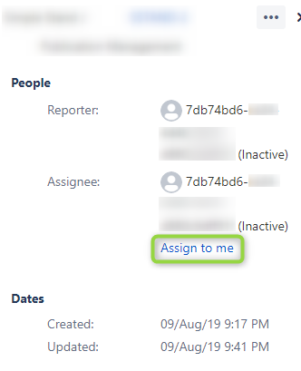

Hello all, I thank you in advance just by reading this.
I performed a migration from Jira server to Jira Cloud and used both the backup zip and the data zip.
The projects, issues and what not imported flawlessly but the users of the issues appear in this UUID form.

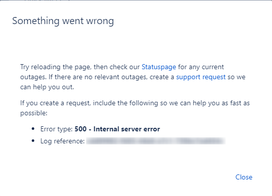

I have no problem changing the users by hand but every time I try to change a user, I get the error displayed in the second image.
It seems that if I create new issues the problem does not happen. The problem seems to happen only in migrated issues.
Could you please elaborate a little bit more on what do your mean by "I have no problem changing the users by hand"? Are you meaning that the assignee/reporter is changed although the error is returned?
I see that the users added to your issues are not currently active and in a weird format. Can you confirm if those users are the ones you imported?

- When I said that "I have no problem changing the users by hand" I meant that since the number of migrated issues was not high, I would be fine reassigning all the issues manually if this error was not occurring and unfortunately no, the assignee/reporter remains unchanged.
