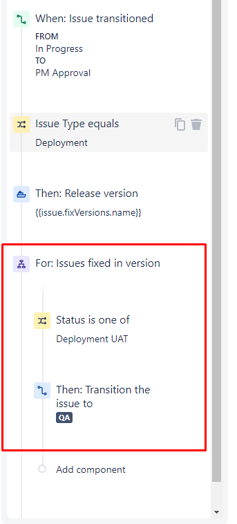

  • I have a jira issue in which I added a fix version.
  • I have created an automation, which will upon transition of this issue release the version.
  • Additionally, what I wanted is that all of the issues in the fix version that was released and are specific status will transition to the next status (marked read).

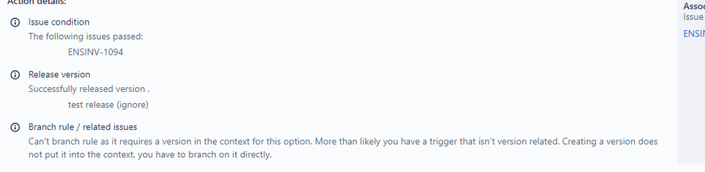

  •  However, the issues are not being transitioned. I am getting the following error.

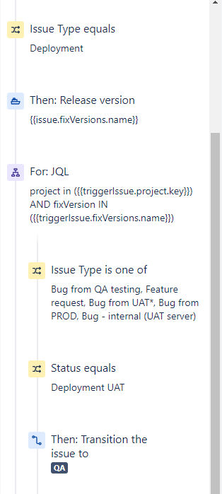

Hi @Sebastian Somi
That branch type works when the trigger is for a version (e.g., version created).
Instead you will want to use a JQL branch to find the issues which have the same fix version as your trigger issue:
project = myProjectName AND fixVersion IN ({{triggerIssue.fixVersions.name}})
Please note: if your issues have more than one fix version assigned you will need to adjust for that case.
Kind regards,
Bill
Sebastian Somi
July 5, 2023
@Bill Sheboy
Thank you so much for pointing me in the right direction. I ended up doing the following. It seems I had to define Issue Type again in order to get the result I wanted.
