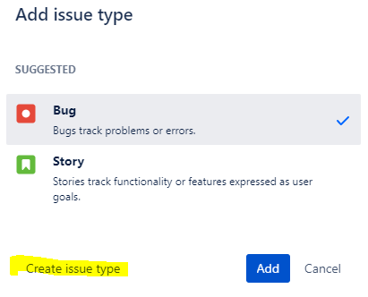

I've just doane this using the following steps.  Navigate to Project Settings > Issue Types
Then click on 'Add issue type'.  The box that appears gives suggested issue types, but if you look to the bottom left, there is 'create issue type'.  You can use this to add your 'test' type.

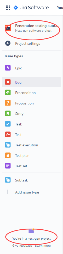

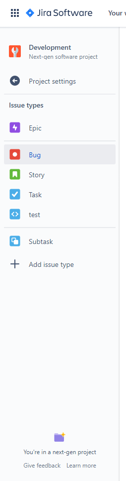

Shiri Reich
October 26, 2020
Thank would make perfect sense if the other project was not next gen - but it is.
This is our current project (with no test issue type):
This is the old project (with test issue type):

Shiri Reich
October 26, 2020
Liam Green
October 26, 2020
Hi
So issue types aren't available to all next gen projects just because they have been added to one.
If you want to recreate your test issue types in the other next gen project you would need to recreate them from scratch.
If you want to replicate settings over a number of projects you would be better using a classic project.
