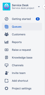

  1. Open up your Service Desk project settingsScreen Shot 2019-05-22 at 9.00.30 AM.png

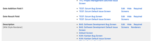

  3. Find "description" and make sure it is a Wiki style renderer Screen Shot 2019-05-22 at 9.01.08 AM.png

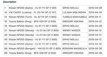

When I put what you sent here into a description that is a wiki style renderer, this is what I got:

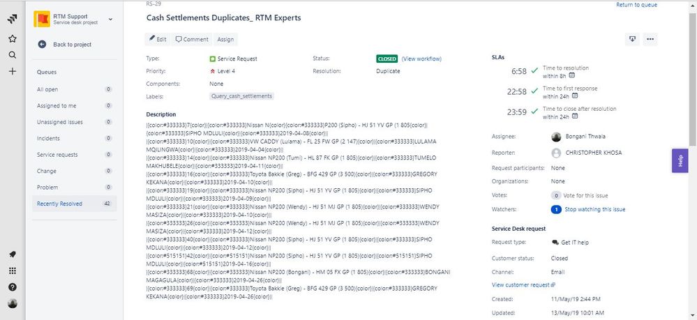

Hi Kian, thanks for your response.
The tickets are sent via email.
The data that you are seeing is from the ticket.
Thank you.

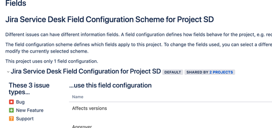

Service Desk projects by default generate their own field configuration scheme. Try navigating to the "Field configuration" section like I recommended. If it is shared, you'll see this at the top "Shared by X projects".
In this case, my scheme is shared by 2 projects. If you don't see that, the scheme you are modifying will only affect your project. Screen Shot 2019-05-22 at 9.19.33 AM.png
