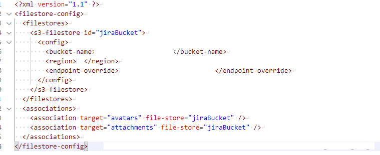

We use the filestore-config.xml to setup our own S3 Bucket.

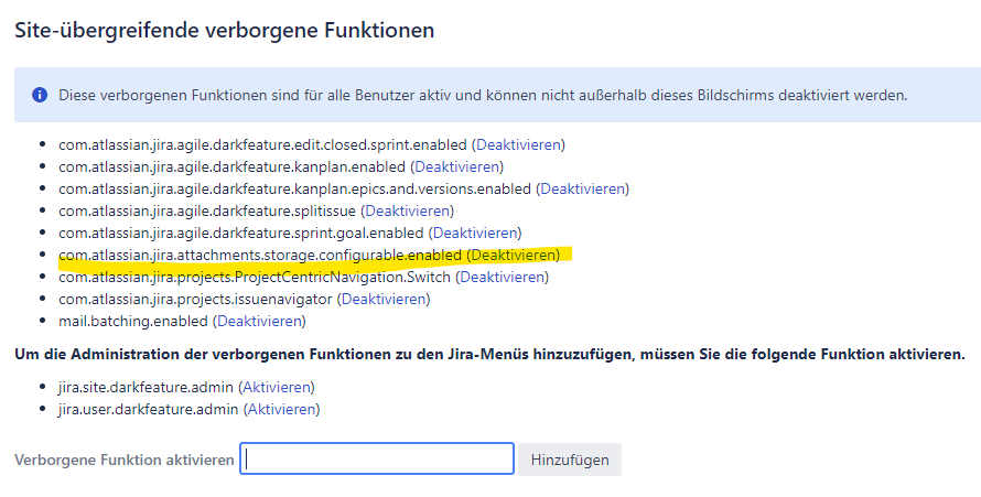

The feature flag was enabled correctly as per these instructions.

if i call GET on the "DarkFeature" <baseURL>/rest/internal/1.0/darkFeatures/com.atlassian.jira.attachments.storage.configurable
It returns "{"enabled": true}" so why the FileStoreSwitcher says it it disabled?

We found the "problem" ... it was the way how we enable the "DarkFeature"
On that page How to manage dark features in Jira | Jira | Atlassian Documentation the sentence
In order to enable a feature flag, type <feature_flag_name>.enabled in the Enable dark feature text area and click the Add button.
does not work with that DarkFeature.
We only have to add "com.atlassian.jira.attachments.storage.configurable" without the ".enabled" at the end and now it works as expected.
We can upload Attachment and they will be saved at the S3 Bucket.
Unfortunately, the corresponding rest call now shows "false".  <baseURL>/rest/internal/1.0/darkFeatures/com.atlassian.jira.attachments.storage.configurable BUT it works.

I think you need to configure 2 separate s3-filestore ids - for avatars and attachments, and pre-create AWS S3 buckets for each of those.

But you did specify bucket name and region?
SvenF
July 1, 2024
yes sure, in my sceenshot above i made it invisible.
