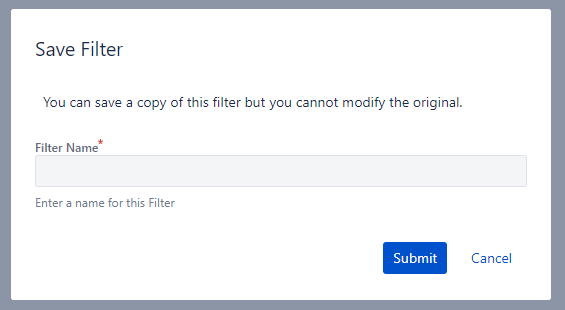

I have created a bunch of filters for my next-gen projects and dashboards.  When I go to edit them, however, it often only allows me to save as, stating:
"This filter was created by [me]. You can save a copy of this filter but you cannot modify the original."
I am a site admin so I do not think it is a permission issue.  Can someone shed some light?
Edit: I do not want to just "save as" the filter under a new name, I want to edit the current one so my dashboard widgets still pull it.

Long shot replying to here 6 months later... but something has changed and I am having the same problem again.
Now I can edit a filter, click search, and am once again unable to update my filter.  The "save as" never does change to "save", even after searching.
The pop up now looks like this:image.png
Any advice?  I want to update this filter without having to make a new one and go change my dashboards.

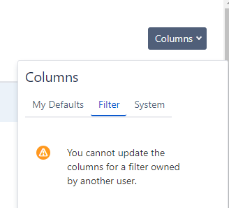

Erin Blomert
May 19, 2021
Hmmm, can't edit columns either (even though I own this filter...).

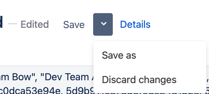

Rick Cosse
September 9, 2021
To add onto this...after editing the query, then running 'Search', the initial 'Save As' button will change to a 'Save' button. Alongside the 'Save' button will be a dropdown with the option to 'Save As'. A very hidden flow with only 1 point of entry. Not obvious. Thank you @Eugene Eng for the step through
