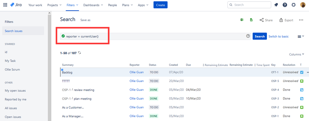

Hi @ZENRO ,
Usually project permission scheme, board filter settings, Mapping statuses to columns, project security scheme will affect the visibility of Issues.
If you can find the created Issue through the following JQL, please check the above four settings one by one.

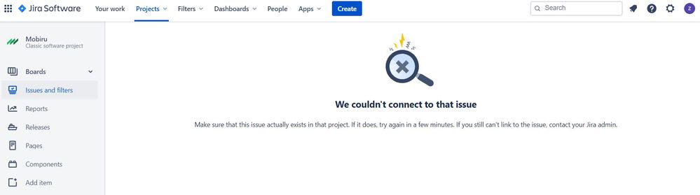

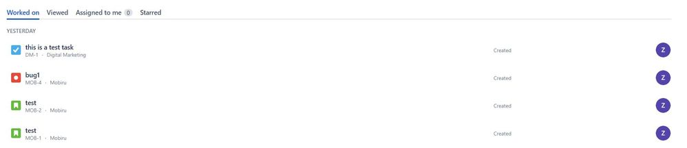

The only way I am able to view the list of issues i created yesterday ,  is by clicking on 'Your work' tab . But again when i click on individual issue , it says 'We couldn't connect to that issue'
