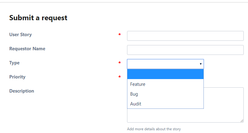

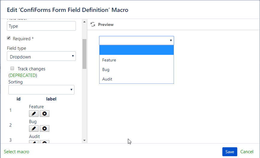

Hi Alex,
The field is defined as a dropdown field. I am not quite sure what you mean when you say the field results into a 'Task'.
I've attached two screenshots to show what the field is defined as and how it appears.

Well, you have the type field as a dropdown, and choices have values 1, 2 and 3
When you do the
[entry.Type]
you reference ID of the field, not a label... if you need to have a label then
[entry.Type.label]
See more on https://wiki.vertuna.com/display/CONFIFORMS/Accessing+field+values+and+properties
Hi Alex,
Thanks a lot! The solution worked for both issue type and priority. I think I was very close earlier on but perhaps there was a mismatch between the entries in our dropdown vs the actual JIRA field values.
