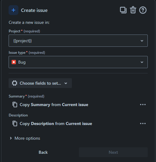

So i want to clone or create a new issue with the same data in a different project. just like  this:
But i always get an Error:
Error creating issue
Specify a valid project ID or key (project)
Issue was created successfully, however some unexpected errors occurred -
Is this possible, do i have to do this via a REST Call or is there a workaround?

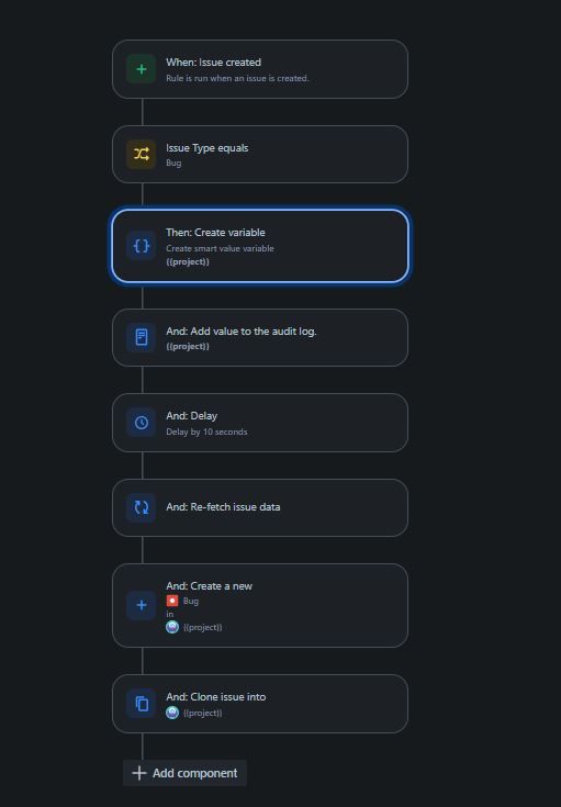

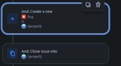

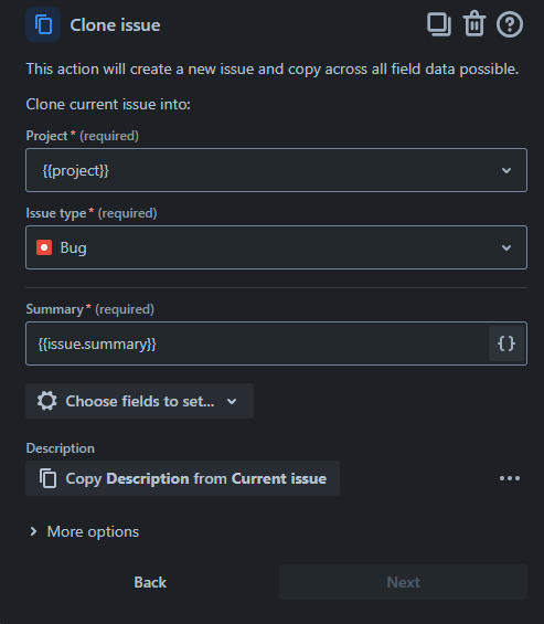

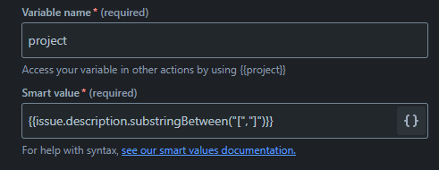

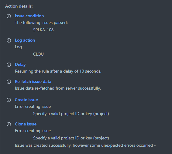

so here are the Details:
  • Company-Managed-Project
  • Audit Log and all the relevant Details:AuditLog.pngCloneIssue.pngCreateNew Issue.pngGetProjectKey.png
So the cloning and creating a new issue doesnt work.
The Project key is also correct

December 6, 2024
Hi @Juergen Koeck
If you add a log action after creating the variable and log the content of the variable.
is this a correct project Key, I suspect so by your mention.
But I think the issues is this text and the project option in the clone and create acton need an value, as the project field is not text.
By using these conditions normally, you will start typing and based on your input a project can be selected. This is an ID.
So in you automation you would need to use the variable to find the correct ID of a project and you that as input
Al theoretically of course :)
Bill Sheboy
December 6, 2024
There is an existing smart value named project, and so it is certainly possible the rule is getting confused by your variable name.  I recommend always adding a prefix to variable names to avoid problems, such as with varProjectId
And as Marc and I have described, you must use the project ID and not the project Key to dynamically select the project for issue creation.
Juergen Koeck
December 9, 2024
Hi @Marc -Devoteam- ,
your theory worked exactly like you predicted.
It worked after querying for the correct ID via the Rest API
Thanks!
