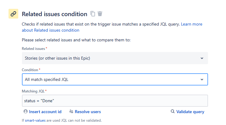

Hi @Aaron Holt
First thing, are you using "blocked" as a status and as a link type?  If so, I recommend not using a "blocked" status, and instead using the built-in Flag feature to indicate blocking.  I find when teams add a status for that condition (i.e., blocked) it becomes a normal part of their flow rather than an exception.  And so they are less likely to mitigate or eliminate future blocks of the same type.
Back to your question, there are a couple of ways to do this in a rule: you could use a related-issues condition with JQL to find the absence of other blocking issues or use a lookup issues action with JQL to test the same thing.  I recommend using lookup issues as you have both more control over its behavior, and I have seen the related-issues condition return incorrect results.

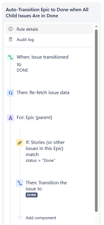

Valerie Knapp
September 14, 2023
Hi @Aaron Holt , welcome to the community and thanks for your question.
We are doing something a little bit like this when the parent issue from the branch is transitioned into a Done state only when all of the child issues are in a Done state.
For me, anyway, the breakthrough moment was the insertion of the 're-fetch the issue data'. How this works is that, when something goes into Done, the data is re-checked and now if the parent meets the criteria to do into Done, in this case, if all the children match the JQL query, then the parent issue is transitioned to Done. You could do something similar from the rule that is running for the blocking issue, when it removed, you could recheck the blocked issue if it doesn't have any more linked issues of blocking to put it into the To Do state.
I hope this helps but if not, please give us your feedback and either I or someone else will try to help.
