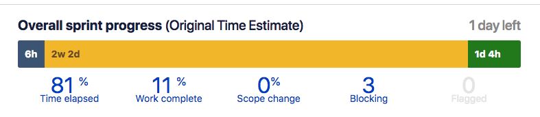

The problem is that this setup affects the reports in JIRA (for example sprint report). In some instances we had to postpone the sprint acceptanc tests (issues remain in "ready for acceptance) and we can't close the stories. Resulting in a non completed sprint (but in reality the sprint is completed since the development is done).

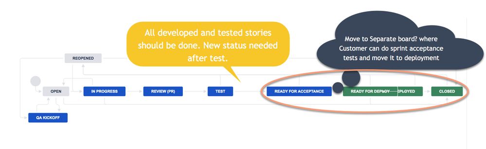

Is it possible to set an issue to "done" without setting it to "closed"? I want it to be done from a sprint perspective but not closed from a customer perspective. Should I split our current workflow into two separate workflows to achieve desired result ? One for the team and one for the customer? (see included picture). Any tip appreciated!

If you want a way to approach this without looking at the process, then you were close, but there is an easier way to work.
Boards are for teams and select issues from anywhere, so instead of setting up projects as containers (and having the pain of having to move issues), create two boards.
Board 1:  For the developers, probably with one column per status until you reach "ready for acceptance".  That status and the three green ones go in the last column on the board.
Board 2:  For the customer, having just the four that are "done" according to the developer board

I think it could - as your developer sprints would close on "waiting for acceptance", (and fails/re-opens could go back into the backlog), and your tester/user sprints would be separated out.  The sprint reports work off the "done" column, and this scheme works for quite a few places I've seen.  As long as you can get your users to accept that "your done is not the same as mine", and you're clear on who is active where, it can work well.

Ok, but would that also mean that we need to apply a "close" status when we put them in done on our dev board? (or the sprint status will continue to look like in the attached example? I also guess that JIRA would treat the stories as "not done/complete" if we don't set them to status "closed"? And JIRA would move them back to the backlog as "not completed" when the sprint is closed? A lot of questions but I just want to be sure that we do this right  :-).

Nope, you can leave them in "ready for acceptance" or the three green ones.  That's what boards are for - representing the workflow in a way that suits each particular team.
When your developers do a sprint report, they'll see those issues as done.  When the sprint is closed, the done issues don't change.
When the testers look, they see stuff that still needs checking and closing off.
The only thing that might be a bit confusing is that your teams need to be doing different sprints on different boards.  In this case, it's a good idea to keep the cadence lock-stepped, so both teams are doing the same length sprints.
