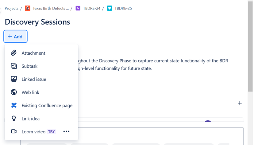

The customer was really vague with his request, but he is stating that he is not able to create child user stories. He is also not still not able to set the parent of a User Story to be a feature.
Hello @Reggie_Hicks
The native Issue Type Hierarchy for Jira is
Epic (level 1)
|-- standard issue types (level 0) i.e. Story, Bug, Task
|-- subtask issue types (level -1)
An issue's parent can be of an issue type in the level directly above it, and its children can be of an issue type in the level directly below it. An issue cannot have a parent or child issue that is from the same level.
Looking at your image I see this in the breadcrumbs
Project / {Project name} / TBCRE-24 / TBDRE-25
That tells me that
- TBDRE-24 is an Epic at level 1
- TBDRE-25 is a child under the Epic, and one of the standard issue types at level 0
I see that in the image the user has clicked on the Add button and the Subtask option is available. For the issue being viewed (TBDRE-25) the only type of child issue that can be added is one from level -1 - the subtask issue types level.

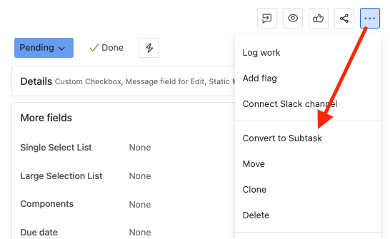

They can convert existing Feature type issues into Subtasks.
Or a new issue type named something like Subtask-Feature could be created at level -1 and they could use that.
Would you have the step by step instructions to do so or at the very least a link that gives a walkthrough on how to do so per the customer, please.
Thanks
Steps for which process? I mentioned two in my last response.
1. Convert an issue that is currently of type "Feature" to the type "Subtask", or
2. Create a new issue type, like "Subtask-Feature"?
That documentation is in the Jira Service Management resources, but the process is the same for issues in a Jira Software project.

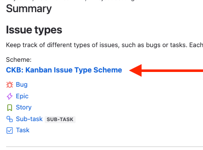

b. Determine the Issue Type Scheme used by the target project.
b1. Navigate to the project and select Project Settings.
b2. Select the Summary page.
b3. Make note of the name of the Issue Type Scheme.
c. Determine if the issue type scheme is used by only that project or by multiple projects.
c1. Click the gear icon near your avatar and select Issues.
c2. In the new navigation panel select Issue Type Schemes
c3. In the list find the Issue Type Scheme identified in B.
c4. Check the Projects column to see if more than one project is listed.
c5. If there is more than one project listed, decide if the new issue type should be added to all the listed projects.
d. If the answer to c5 is YES, add the issue type from A to the issue type scheme from B.
https://support.atlassian.com/jira-cloud-administration/docs/add-edit-and-delete-an-issue-type-scheme/
e. If the answer to c5 is NO, then
e1. create a new Issue Type Scheme by copying the existing one,
e2. add the new issue type to the new Issue Type Scheme
e3. associate the new Issue Type Scheme to the target project.
https://support.atlassian.com/jira-cloud-administration/docs/associate-issue-types-with-projects/
