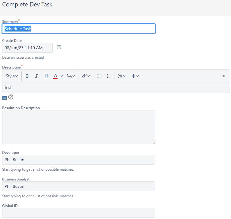

Phil Bustin
June 8, 2023
In a transition screen, I want the all the fields you see in the screenshot below to be viewed by the Assignee because they provide important context, but the only field I want editable is the Required field 'Resolution Description'.
Transition screen:
Like John Funk likes this
Trudy Claspill
June 8, 2023
Is the user able to edit those fields before they start the transition?
If they are able to edit the fields before they start the transition, then why do the fields need to be locked while they are making the transition?
Phil Bustin
June 8, 2023
I somehow never looked at the view screen; always just went right for the transition.
The Assignee can update some of the fields in the view screen, and some not.  I don't understand why that is.
While I understand the logic of allowing updates in the view screen and then removing them from the transition screen, I personally have needed context reminders when I transition issues.  Maybe I have a short memory, but I've seen others express the same wish.  It happens often enough that one is drawn away from completing a transition, and needs some reminders when returning to the task.
So for now, I'll consider removing updatable fields from the transition screen.  If we get ScriptRunner (and we might), I'll likely make some fields read-only in the transition, if ScriptRunner works.
