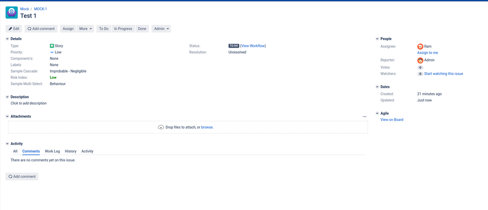

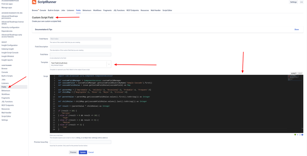

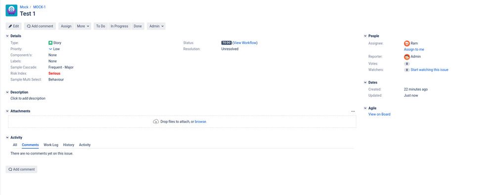

Below is a screenshot of the Scripted Field's configuration:-
The screenshot above shows that the Scripted Field type used Custom Script Field, and the Template used is Text-Field (multi-line).

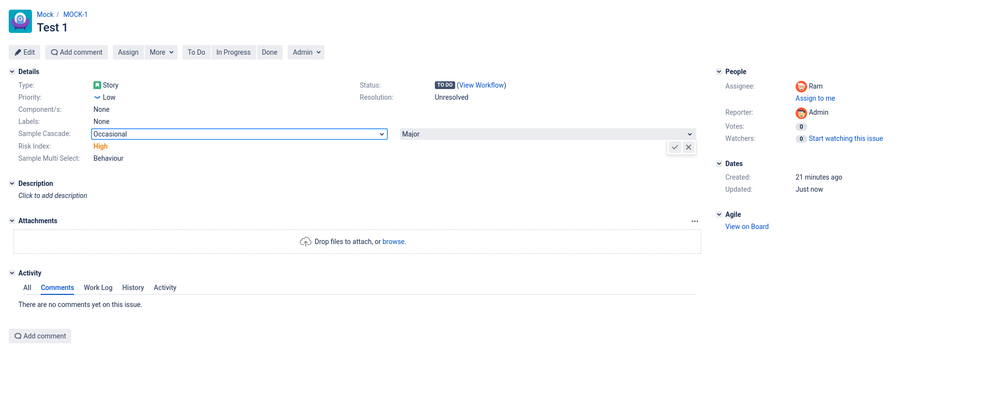

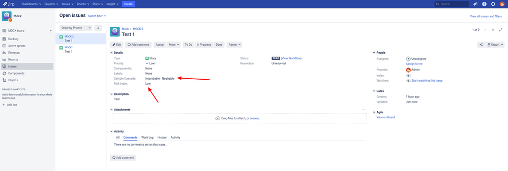

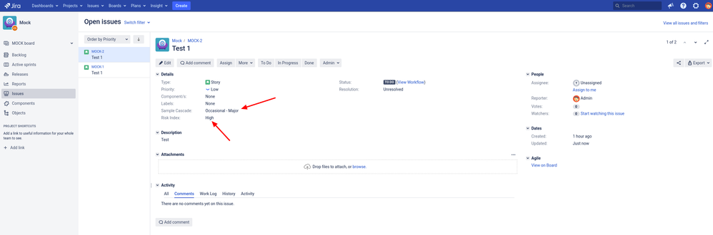

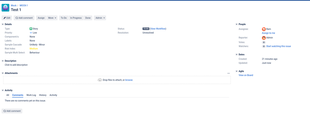

Below are a few test screens for your information:-
1) Improbable and Negligible options were selected from the cascading list when the issue was first created. As a result, the Risk Index scripted field is updated to Low as shown below:-
2) When the cascading field options are then updated to Occasional and Major, the Risk Index Scripted Field is accordingly updated to High, as shown below:-
3) Accordingly, when the Cascading field options are updated to Frequent and Critical, the Risk Index Scripted Field is updated to Serious, as shown below:-

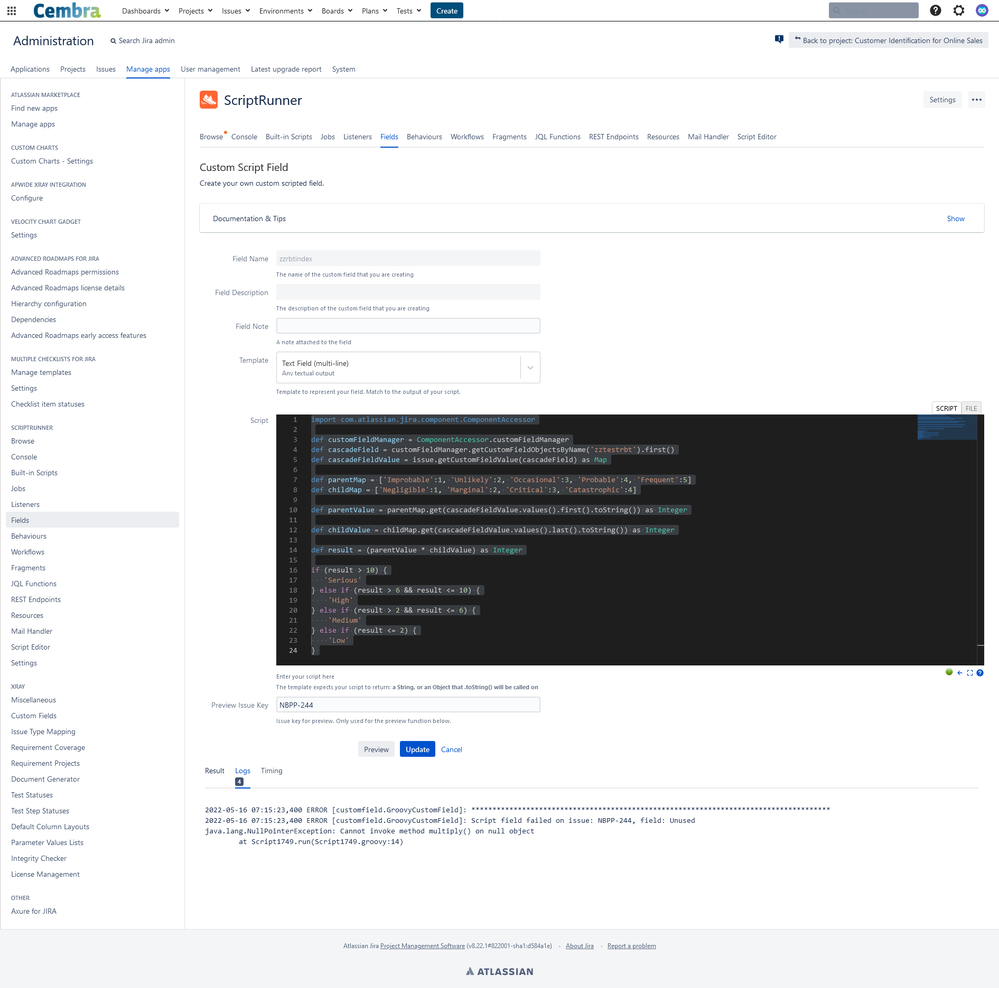

Vedat Ozdemirler
May 16, 2022
Hi Ram
Here are the code and screenshot you requested.

Error on Preview:
java.lang.NullPointerException: Cannot invoke method multiply() on null object at Script1749.run(Script1749.groovy:14)
An error occurred, the field will have no value
Ram Kumar Aravindakshan _Adaptavist_
May 16, 2022
Hi @Vedat Ozdemirler
After comparing the error message to the code that you have shared, it appears that the error is coming from this line:-
def result = (parentValue * childValue) as Integer
I can confirm that the NullPointerException is returned because you have only selected one option from the cascading list, i.e. the parent and nothing is selected from the child.
You need to select from both the parent and child list for the calculation to work correctly.

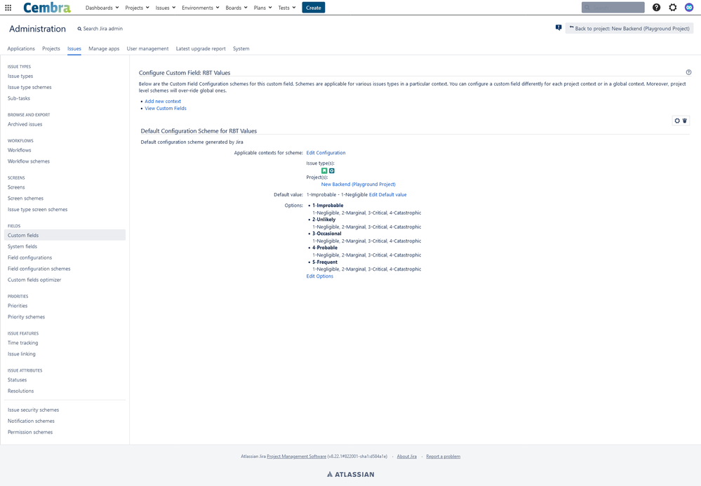

Vedat Ozdemirler
May 16, 2022
Hi Ram,
Thank you for the updates. It seems that I am getting null for values regardless of what I select on the cascading field. Would it be possible to get the values for that field using the custom field ID (customfield_12004) instead of the name?
Here are the custom field details.
Regards,
Vedat

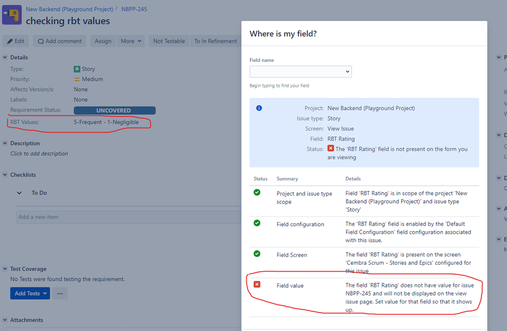

Vedat Ozdemirler
May 16, 2022
Hi Ram,
I wanted to get a clean start and deleted the zztestrbt cascading field and zzrbtindex custom script field then I created new RBT Values cascading field and RBT Rating custom script field with below code. This is still giving me null return and RBT Rating is not displayed on my selected screens.
import com.atlassian.jira.component.ComponentAccessor
def customFieldManager = ComponentAccessor.customFieldManager
def cascadeField = customFieldManager.getCustomFieldObjectsByName('RBT Values').first()
May 16, 2022
Could you please provide the error that you are getting in the atlassian-jira.log file when you try to test the code?
Also, can you confirm if you have more than one field with the name RBT Values? If yes, then you should use the custom field id instead of the field name.

I have one more question: How can I display the RBT Rating in color or highlight?
Regards,
Vedat
May 20, 2022
To answer your question, if you want to colour the scripted field, you should try something like this:-

The HTML parameters added to the results will change the colour of the field based on the result.
Some print screens for your reference:-
I hope this helps to solve your question. :)
Thank you and Kind regards,
Ram
