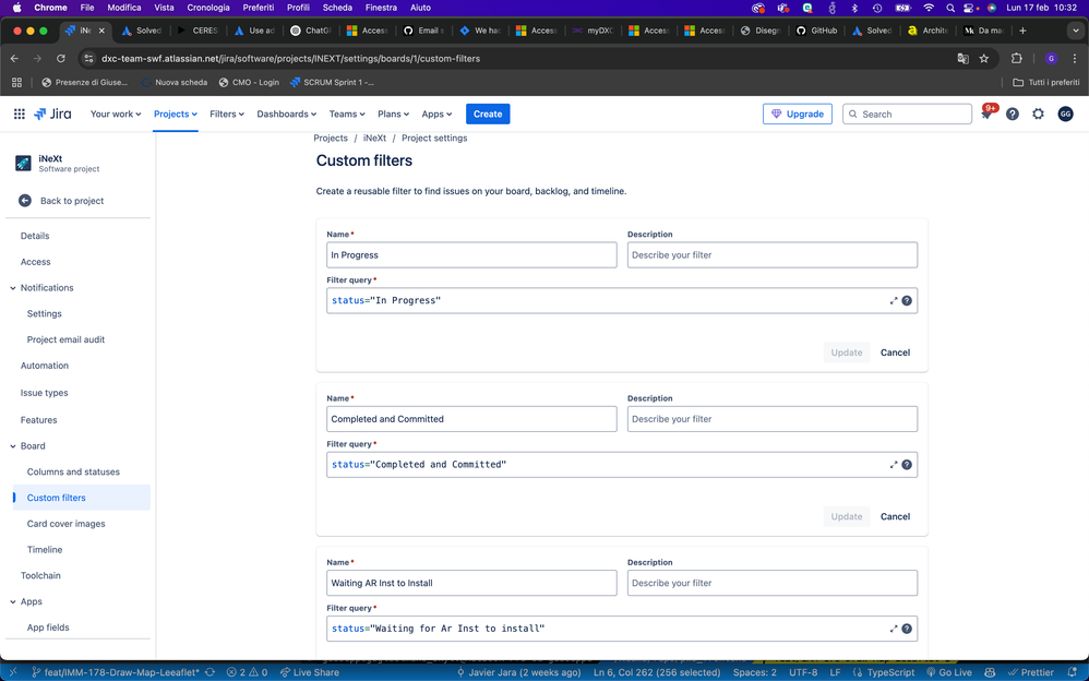

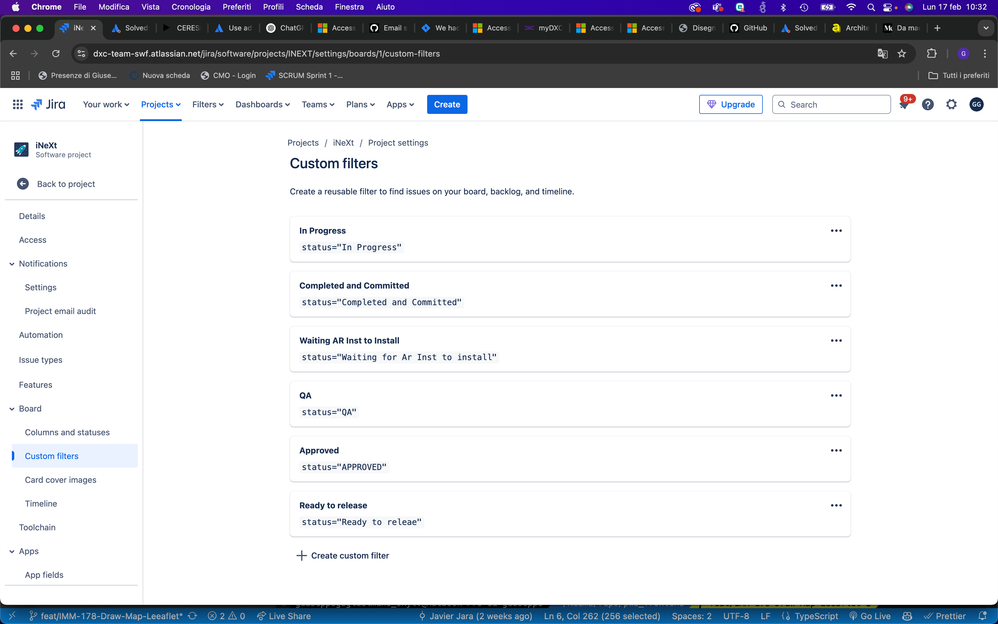

Hi there
I think my question is quite simple
I created this custom filters
Filter 1
status="In progress"
Filter 2
status="Completed and Committed"
Filter 3
status="QA"
In my board, they worked perfectly as single filter but when I try to combine them like checking at the same time Filter 1 and Filter 2, no tickets are showed in my board

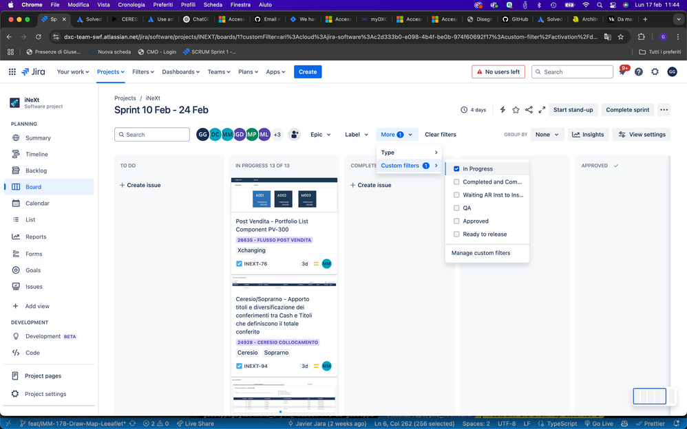

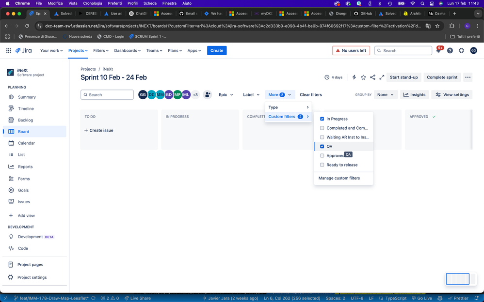

Giuseppe Guglielmino
February 17, 2025
Thanks for all your answer
Here below you can find the screenshot you asked for.
I tried to insert "And" operator either at the beginning and end of the JQL expression, but it didn't allow to do that.
Maybe I need a different approach.
Do you have any advice about it ?Schermata 2025-02-17 alle 11.44.39.pngSchermata 2025-02-17 alle 11.43.50.png
