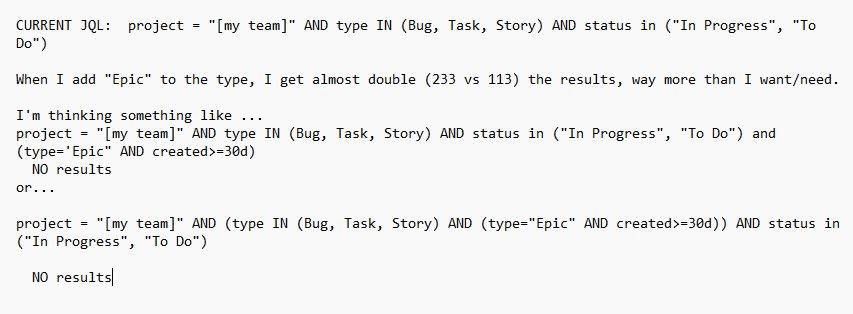

It wouldn't let me post the text, HTML error.
I want just the Bug, Task, Story, but for those Epics created in the last 30 days.

Next, you have different criteria for your Epics than for the other work item types.  In that case, it helps to restructure your query like this:
conditions that apply to everything
AND (
(conditions that apply to Epics)
OR
(conditions that apply to Bug, Task, Story)
The parentheses are key to ensure the correct grouping of the conditions.

Dave Van Hecke
August 22, 2025
This seems to work, but I need to do more testing and confirm with a colleague on the results.  Thank you!

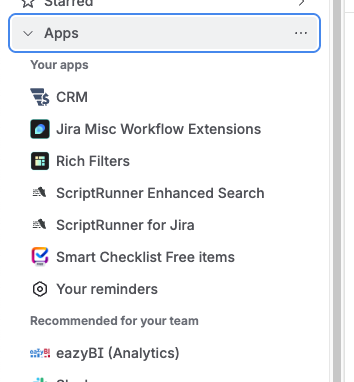

If you expand Apps in the navigation bar, what do you see?
Like # people like this
Dave Van Hecke
August 22, 2025
None.
