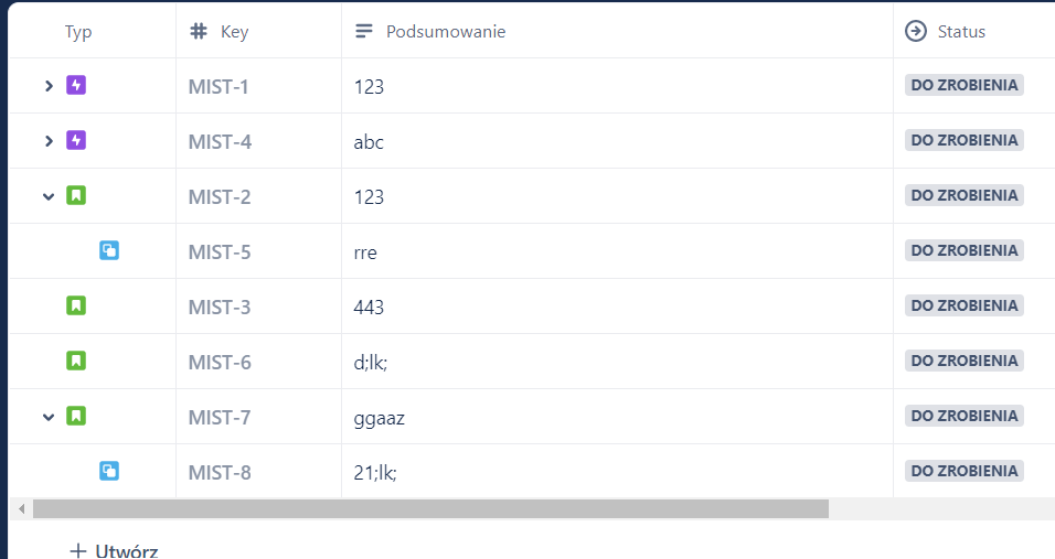

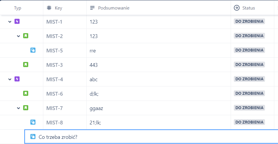

Camp Bursztynowy Las
October 21, 2022
@Curt Holley - I am having issues with how this type of hierarchy is displayed on the list or board view. Jira seems to loose the Epic/Task relationship and show epics above and stories below after you refresh the screen the issues are still properly linked, just not shown correctly.
Have you come across this issue? Do you know if there's a solve for this on a free plan?before screen refresh.pngafter screen refresh.png
