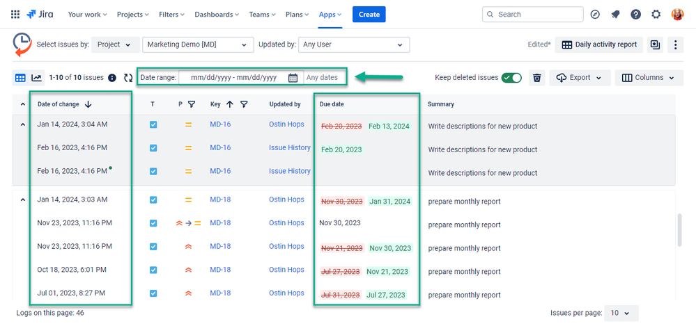

Hi @Caleb Park
As an alternative solution, you can try Issue History for Jira from my team. It records changes for all standard and custom fields. You can also select a specific date or date range for which you want to get updates and export the report if you need to.
Here is an example with due dates, but it can be any custom field.
The app is available for Cloud and Data Center users.
