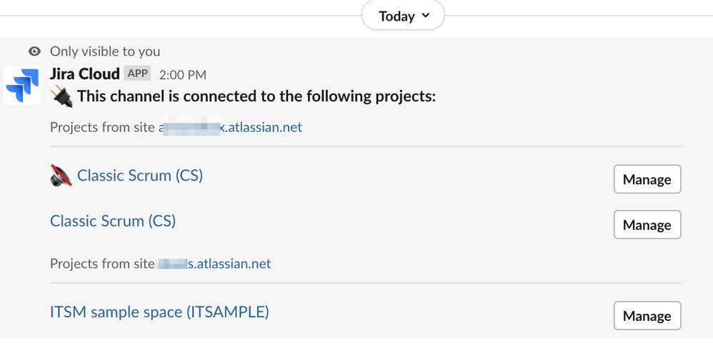

My recommendation would be to start in Slack - in the channel you want to stop notifications from coming in to, use the /jira manage command. This will give you a list of which Jira projects are connected to the channel:
You can use the Manage button there to open the configuration in Jira and make changes. Projects can still be connected to a channel without sending notifications - for example, you can see the first entry in the screenshot has the muted (🔇) icon. This lets you show issue previews if someone mentions an issue key, without sending notifications on changes into the channel.
