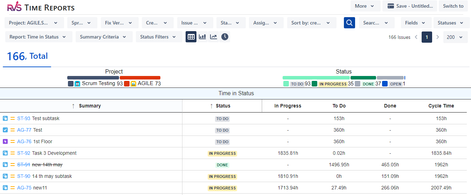

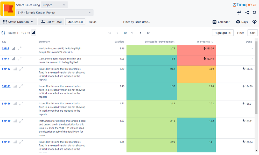

For a readily available solution, to calculate the age of an issue, you might be interested in a mktplace app,
Time in Status Reports
The "Time in Status" report with Status grouping feature, and the "Time between Statuses" report can help to meet your use case of calculating the issue age. Also the app has 20+ reports to meet a variety of use cases.
More details here.

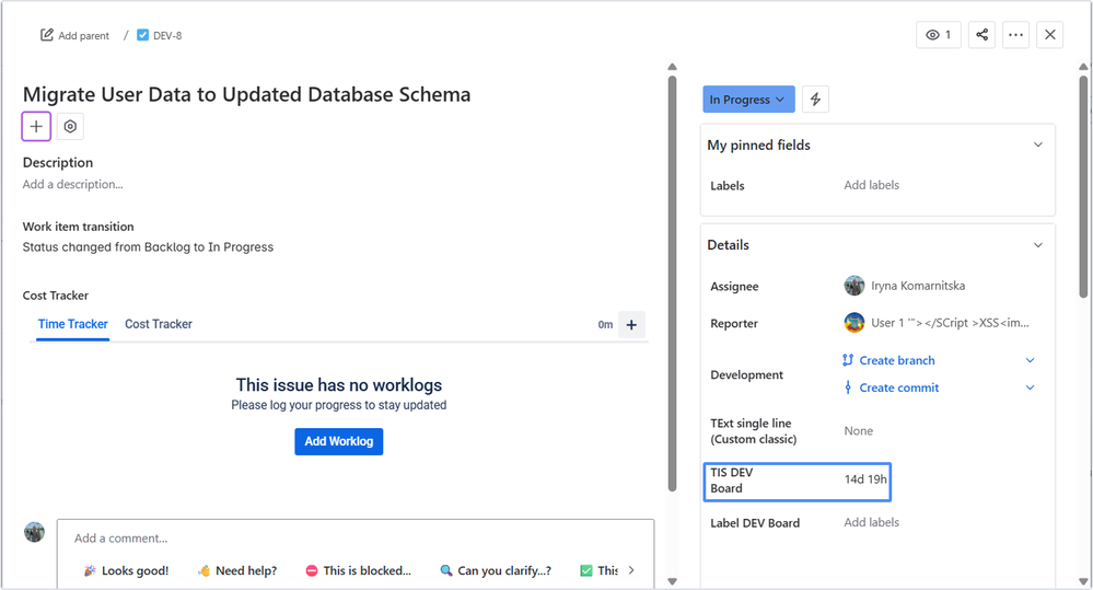

Hi @Dinakaran R ,
If you're looking to track issue age or custom SLA metrics in Jira, you can use the Custom Fields feature in the Time in Status app. It displays the time an issue has spent in its current status directly on the board and can be used in JQL. (Note: Only admins can create custom fields, and it's available for company-managed projects.)

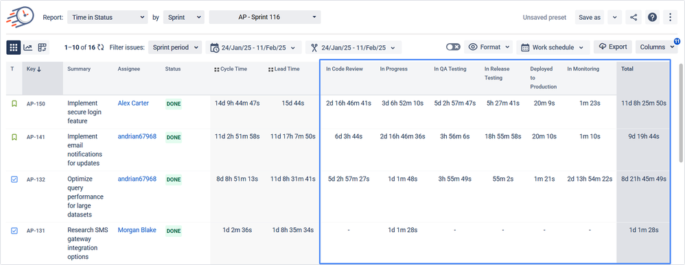

To calculate the total age of an issue — not just the current status — you can generate a Time in Status report in the same app. The "Total" column will show the full issue age, and you can even create custom Status Groups to track specific workflow metrics.

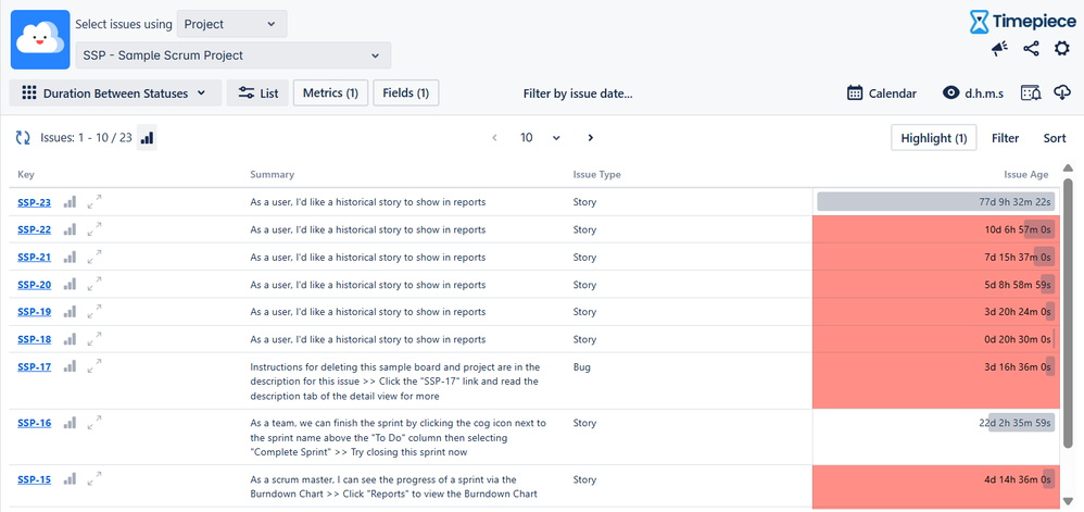

Our app, Timepiece - Time in Status for Jira, is built specifically for this purpose. It allows you to create dynamic reports for time-based metrics that directly address your requirements:
Sort by Age or SLA Time: You can generate a report showing real-time issue age or time spent in the current status. The key feature here is that you can simply click the column header to sort the entire list by that calculated time. This brings the oldest or most urgent issues to the top.
Live Views on Your Dashboard: Any report you create can be displayed in a Timepiece gadget on your Jira dashboard. This gives your team constant and immediate visibility of aging tickets or issues about to breach their SLA, right from your main workspace.
Highlight Critical Issues: To make urgent issues stand out even more, you can set thresholds to visually highlight them. For instance, any issue older than 7 days can be automatically colored red, making it impossible to miss during a quick scan.

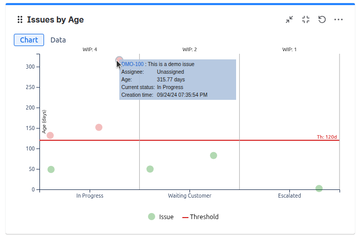

Not sure if if is possible to add age as a field, but in JQL you try queries like these:
"Time to resolution" > 12h - for issues that took longer than 12h
created > startOfDay(-10) - for issues with age > 10 days

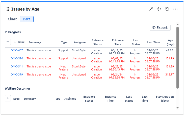

For something better, and if you want to try a plugin from Atlassian Marketplace, you can get a diagram and a report about the age of the issues by using the WIP Aging Chart gadget offered by our Great Gadgets app.
On its data tab, the report shows the issue by their age:
The same app offers also Control Chart gadgetHistogram Chart gadget and Time in Status gadget that you can use to track issues by SLA and easily identify SLA breaches.
