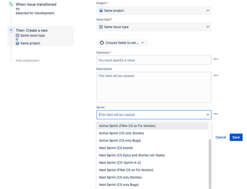

An issue has a workflow that indicates the Statuses it transitions through. If the issues are in different projects and the projects use different workflows for that issue type, then you can't really have that one issue running through two different workflows in different projects and in different sprints.
I recommend that you look at using automation to create a new issue in the developers' project that is a copy of the issue from the project managers' project and link the issues together. That would get it into the backlog of the developers' project.
Within the Automation Rule when you are creating the new issue in the developers' project you can also set the Sprint field. There is a Next Sprint option that you can use (you have to specify the board in which that sprint was created). If you have multiple planned sprints defined in the developers' project board I'm not sure if Next Sprint will get you what you want.
In the example below you would set up the rule to run against the project managers/ project, and then in the Create Issue component you would specify the developers' project as the project in which the new issue would be created.
For copying the information from the source issue you would set fields in the destination issue to smart values, using the {{triggerIssue}} object to get the data from fields in the source issue.

My suggestion applies to your scenario. It doesn't matter that the issues are in different types (Team vs. Company) projects. You don't need to create a Company Managed project for the project managers'.
You define the Rule to be triggered by transitioning issue only in the project managers' project, and set the action to create copies of the issues in the developers' project. If you construct the rule correctly it will not create issues in the project managers' project based on issues in the developers' project.
