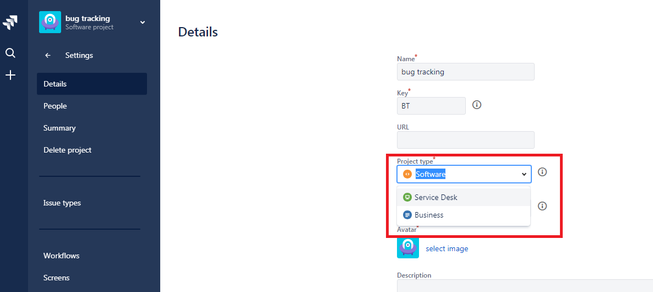

You can change the template.
Go to the Project Configuration and then choose the Details tab. You will be able to change the template there:

Be aware that this only changes the project "type".
The "template" is only used when you create a project, it's just telling Jira how to do the initial setup.  Changing the type will not re-configure the project.

Yes I am looking to change the template.  Currently default is set to SCRUM but I need to change to something else now.  This is not possible?
Nic Brough -Adaptavist-
May 3, 2018
Scrum is a template within the "Software" type.  As I said, only the type will change.
