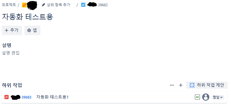

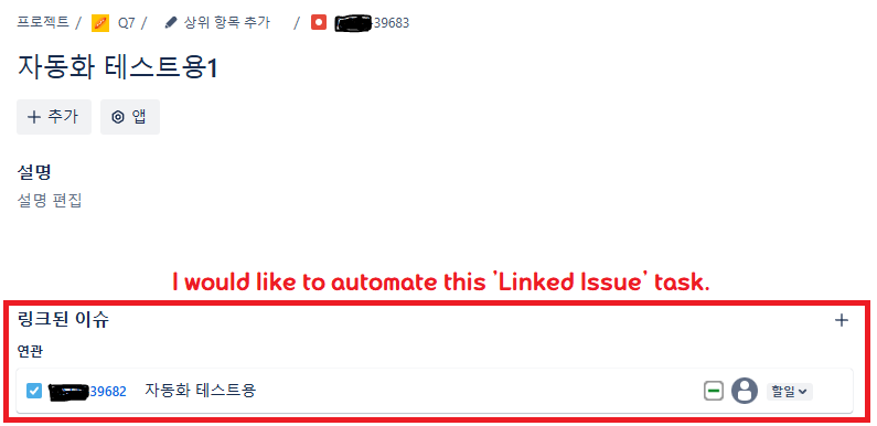

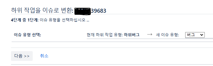

When a 'sub-item' of an issue type 'Task', 'sub-bug', is converted to a 'bug' type, is it possible to create an automated statement that registers the 'bug' issue as an issue that links the previous 'parent item' issue?
Reproduction order and expected results.
1. A ‘task’ connected to B ‘sub-bug’
2. B ‘sub-bug’ → B ‘bug’
3. B 'Bug' - A 'Task' (related to) // Jira Automation

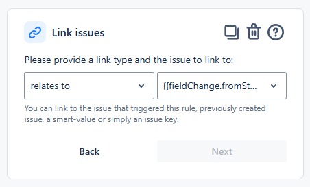

If I got your requirement correctly (as described in my answer to your last post) the following rule should do the work

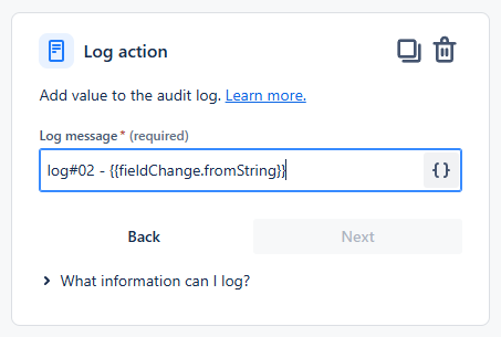

Whenever a Sub-Bug is converted to a Bug an issue link between the (new) standalone Bug and its former parent issue is created
(the issueType condition is optional - if added it needs to be configured regarding your conditions)
As you can see in the "link issue" action a smart value is used for the issue to be linked at (which is the former parent):
{{fieldChange.fromString}}
Please give it a shot and let us know if it works or if there are any further questions. In case there are any further problems please provide some material for analyse like screenshots of your rule and audit log

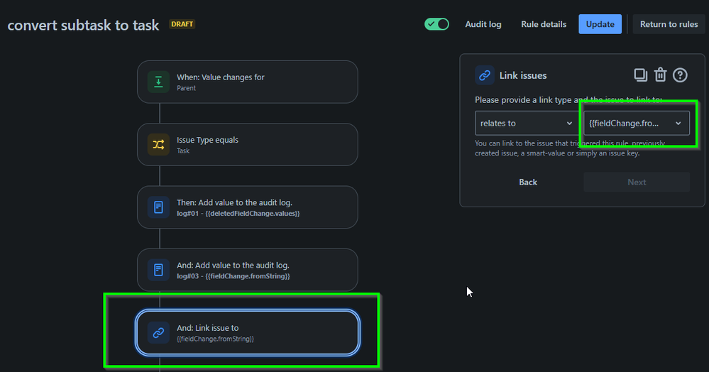

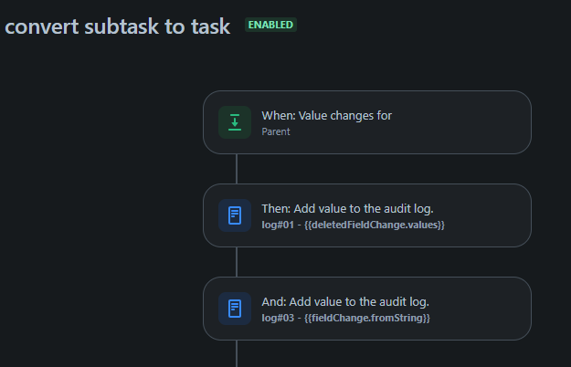

clown
December 5, 2024
This was the result of the first answerer's solution first.
Even when I applied the answer you provided, it still didn't work.
There was no audit log left either.

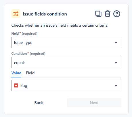

Stefan Salzl
December 5, 2024
Hi,
was there no audit log? Not even an error? no execution at all?
First thing I can see kn your screenshot: your condition checking for issuetype task. As I mentioned in my answer you have to change the condition to the issuetype you are converting to. So when you gonna convert a sub-bug to a bug the condition of your screenshot will be fals therefore the rule won‘t do anything. in this case you need to change the condition to bug. The condition could even be left out at all. that would be good for tests so we know the rule is activating ar your side.
Could you please also share a screenshot of the details of your rule details as well as from your trigger details and also a step by step description what you are doing when you expect the rule to activate.
Best
Stefan

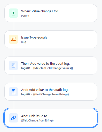

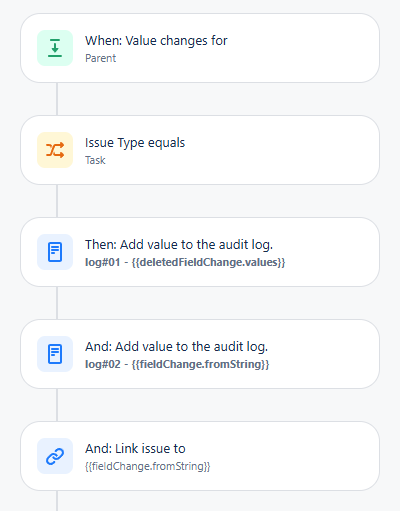

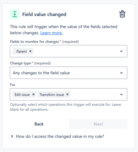

clown
December 9, 2024
Hi, Stefan! Sorry for the late reply, I was busy.
First of all, there was no Audit log, and there was no Error.
The direction I want is as follows.
When a Sub-bug, which is a sub-item of a Task, is converted to a Bug issue, a relates to link is attached to each task.
Below is the syntax written.
Thank you for your favor.
Stefan Salzl
December 10, 2024
Hi @clown
try without the limitations in for events in the trigger.
Converting an issue is neither an edit nor a transition action. Seems the rule won‘t start according to this condition.
Best
Stefsn
clown
December 11, 2024
Problem solved, thank you Stefan!!

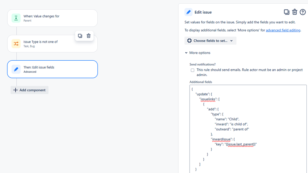

Marcos Defina
December 2, 2024
When a subtask is converted to task, or a sub-bug is converted to bug - their Parent field is cleaned.
You can use this as a trigger.
Now, to recover the previous parent with no external script will be a problem.
If you are able to script in python, you can create a listener to this event and previous parent information from the history.
But if not, you can create a custom_field (lets call it last_parent) that would hold parent information during creation. Just create a post-function to update your last_parent to the current parent on sub-task creation time - in this way you will be able to recover last_parent once the sub-task gets promoted to task.
Then your automation will look somewhat like this:Screenshot 2024-12-02 234338.png
  1. When Value of Parent changes to Empty
  2. If Issue Type In {Task, Bug}
  3. Edit Issue Fields using Advanced Field Editing to insert current_issue.last_parent into the new issuelinks (this part will take some trying and error to get the syntax correct)
Hope it helps!
