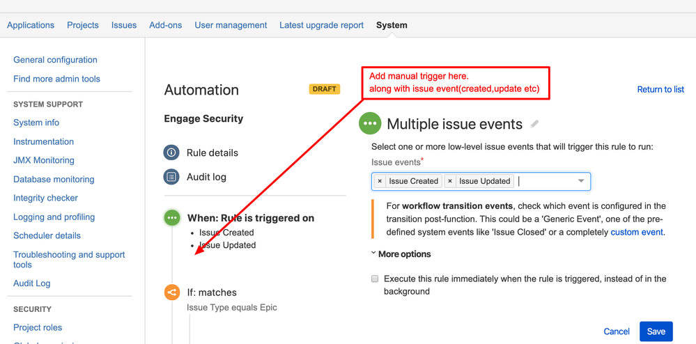

Hello,
I have one "Manual Trigger" automation rule. I want to add more trigger such as "issue created", "issue updated", etc as well.
How can I do that?  Currently I'm seeing only one trigger(either manual or issue created and or issue updated etc). But I want both manual trigger and issue created trigger execute this automation rule.
Note - I can copy the rule and change trigger to issue created or updated but in that case every time required changes I'l have to do manually update both the rule(s), I want to avoid that.
Thanks
Masud

Hi Masud,
I understand that you're using the Automation for Jira Server plugin to create some rules, and that you want to be able to create a rule that has both multiple triggers and a manual trigger.
This is not something that can currently be done with the Automation for Jira Server add-on in the current versions.  The manual trigger run is not designed to have other possible triggers.  Its intention is to let you choose when to run an automation rule and not to have it be based on a process or workflow step to trigger the rule.  More details on that rule can be found in Manually run a rule against an issue.
I suspect that this is done by design.  In my view the Manual trigger is not technically an issue event in the same way that issue created, issue edited, issue closed, etc are.  That said, I do agree that this would be useful to have. So I created a feature request for this over in JIRAAUTOSERVER-14.
In the meantime, the best I can seem to do is to first create the multiple issue event trigger rule, then copy it, and in the copied one edit the trigger to just be manual.  I know that isn't an ideal workaround as it creates an extra rule to manage, but at least it might help to give you the immediate functionality desired.
