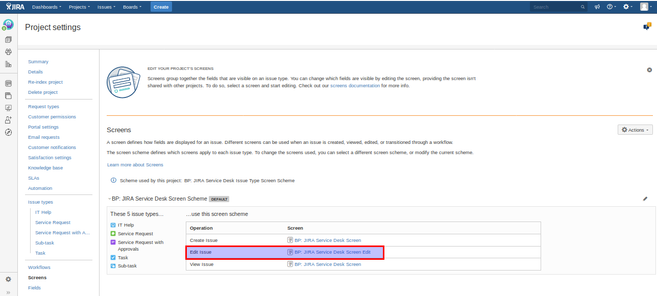

Alexey Matveev
March 29, 2018
You should create a different screen for the edit view screen and remove the required field from the screen and attach the screen to the screen scheme in the project. I attached a screenshot:
Kindly read the articles below:
https://confluence.atlassian.com/adminjiraserver/defining-a-screen-938847288.html
https://confluence.atlassian.com/adminjiracloud/associating-screen-and-issue-operation-mappings-with-an-issue-type-776636504.html
