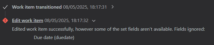

I have tasks transitioning from one stage of work (status) to the next, and along with this I need to add, for example 3 days to already set due date automatically.
I've added the action edit due date and tried smart values such as {{now.plusBusinessDays(3)}} {{issue.duedate.plusBusinessDays(3)}} {{issue.created.plusBusinessDays(3)}} but none of them work. I also tried adding conditions like due date is not empty. I also always add a condition to specify issue type. And I always get one error in the log (the field due date is available in the work types)

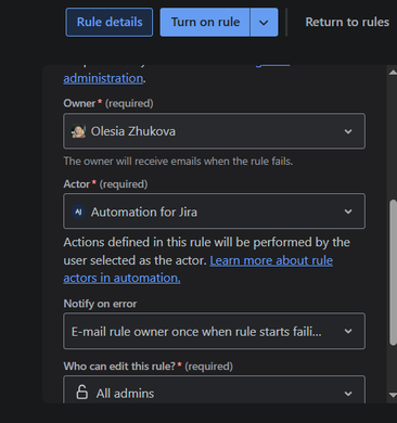

#1) Who is the rule actor in the details at the top of the rule?
The default is Automation for Jira, and that user should have the permissions needed for the rule.  If someone changed the actor, why did they do so?  I believe changing the Due Date requires the "Scheduled Issue" permission, and perhaps a different user does not have that one.

The rule actor is automation for Jira, and I didn't find the Permissions Schemes tab.

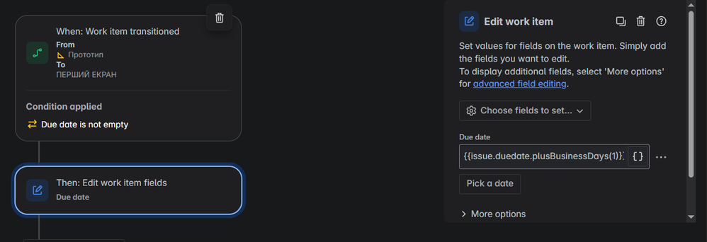

Here's the complete rule.

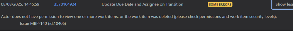

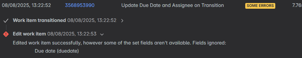

And here's the audit log details
I've set up all of the possible permissions I am pretty sure I didn't miss anything there.

Finally, your new / second rule does show you do not have permissions to schedule work items (i.e., change the Due Date) and so leave the rule actor as the default: Automation for Jira user.

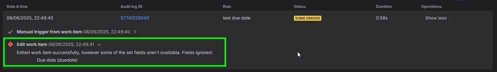

I noticed that no metter the actor or rule, the automation ignores editing fields. Like other actions work fine, but this exact one doesn't. So far it works only in three rules that I've made and i don't see why there it does work but on the other rules it does not.

could you please also send a screenshot of your rule to see how the edit actions are configured.

My rules look like this mostly.

In the screenshot it only shows one closing } . But I guess this is only hidden by the end of the field.
