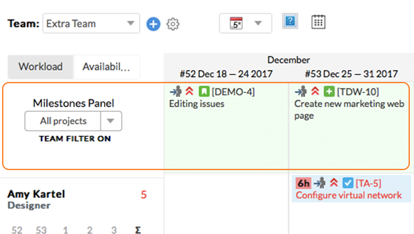

Nataliya Vasyliv_Reliex_
Atlassian Partner
October 19, 2021
Hi @Marco Rodrigues
to find a specific completed task as a Milestone you can try Activitytimeline add-on. There you can add Milestone to a timeline and use for all or for one specific project. 2021-10-19_19h37_19.png
