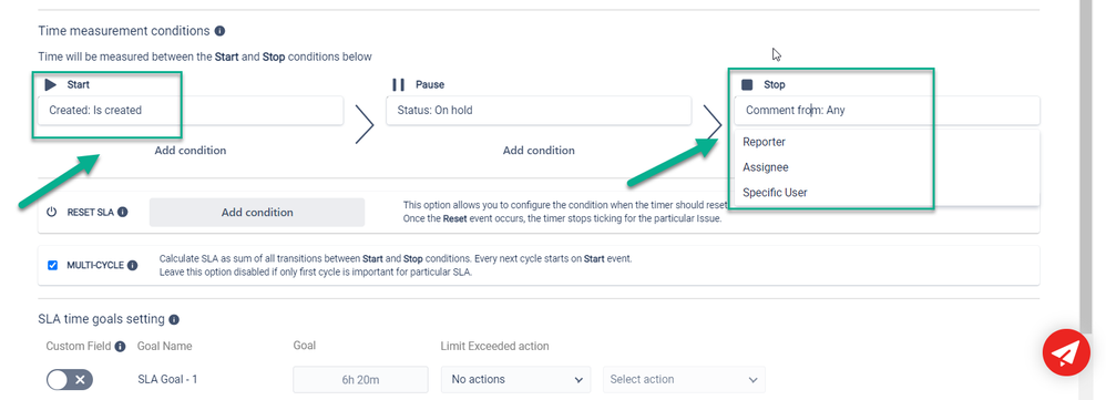

Hi @David Loszewski
For this case, you can try SLA Time and Report from the marketplace. This tool allows set timer  accourding to your needs: start - issue created, stop - added comment.
Also you can set time goals and track timer data on the issue view tab.
If you have any questions let me know, because this app is created by my team.

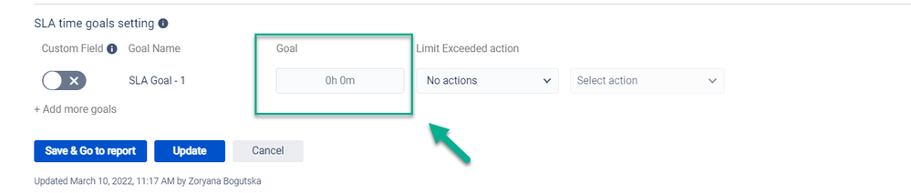

Thanks! is there any way to show the elapsed time opposed to the time until SLA?
Zoryana Bohutska _SaaSJet_
Atlassian Partner
March 10, 2022
You can set SLA Time goal for example 1m or 0m and then you will see time elapsed

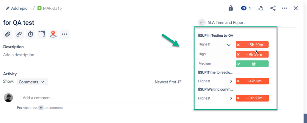

Thank you! Is there a way to view that field in a search or in confluence?  The only two custom fields I see are SLA Goal - 1 status and Target date for SLA Goal -1
David Loszewski
March 10, 2022
I'm also wondering if there's a way to change change the colors since red is not considered as "good".  And also get rid of the '-' in the number.

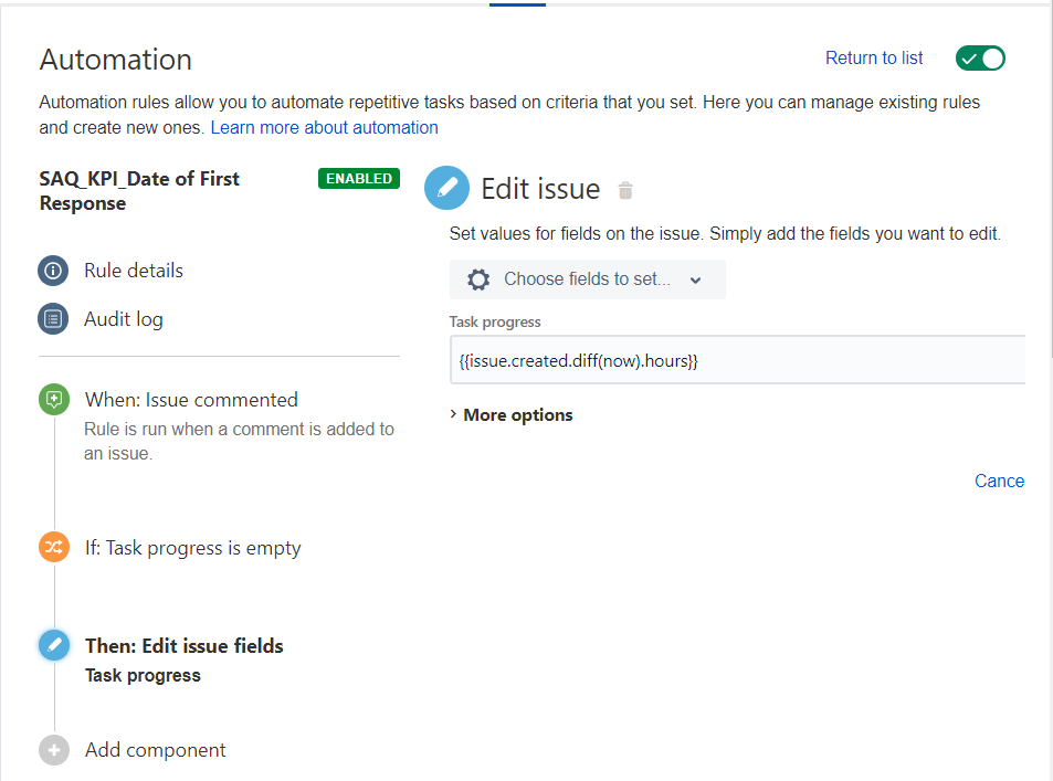

Hi @David Loszewski
How about doing it with Jira Automation?
  1. Create a custom field which stores your calculation
  2. Add an automation with these steps
    1. When: Issue Commented
      This rule will be triggered for every comment
    2. If: Your custom field is empty
      That's a workaround to filter for the first comment only.
    3. Then: Edit your custom field with a smart value like:
      {{issue.created.diff(now).hours}}
Would that work for you?
Cheers,
Matthias.
PS: Here's more background info about Jira Automation and about working with dates.

Constanze Schmidt
August 29, 2024
Hi Matthias,
I just read David´s question and your suggestion about Jira automation and I´m quite thrilled, because this is exactly the problem I had and the solution I was looking for.
I am not into programming and never used automation before, but with your help, it seemed straight forward enough.

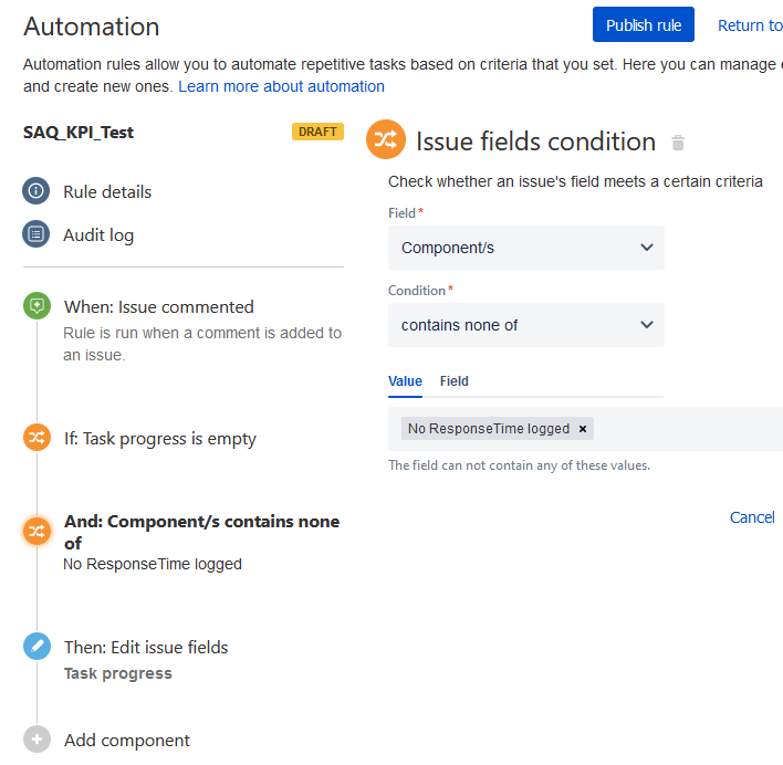

Here´s the rule I created:
And it worked!  So happy :-):-) ;-)
Then we realized that the custom field we implemented for the rule was also inserted in all issues created before we installed the rule and because of that, the comment created after the installation was considered as first comment, since the custom field was - of course - empty - no matter how many comments the issue already had.  That led to ridiculous  response times - a no go.
So I decided to mark the older issues with a label or another handy field and include this in the rule.
I chose the field 'Component/s', because it is not used in that project, named it 'No ReponseTime logged' and added it via bulk operation to the older issues.
Then I added a second condition to the rule, excluding the component - and that did the trick.image.png
